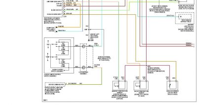

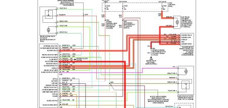

TOM RICHARDSON
The blower motor was intermittant . now it doesn't work on heat or A/C. I assumed the motor was bad , but I jumped it to the battery first and it works fine.
I checked the power lead to the blower and find 5 v on high setting. When I have someone press the control for slower fan speed, the volts drop about 1 volt each time. I can't find a book for my year Towncar. I do have a manual for 87 to 97. It talks about checking the blower motor resistors and shows a picture, on the older ones being on the fire wall. I couldn't find any.
Could the probem be in the control module on the dash? Or.. could I have a loose connection? Either in a wiring connection or onto the control module itself?
Would that be likley to cause a voltage drop to 5 volts and why it was intermittant?
Jun 23, 2020 at 7:18 AM (Merged)
BUDDYCRAIGG
  • 2,262 POSTS
if the heater control head has an AUTO option, and you can just set it to whatever temp you want, then it has auto heat.
  • 75,992 POSTS
Hi Tom Richardson, Welcome to 2carpros and TY for the donation Your probable causes here could be the blower motor speed controller or the electronic automatic temperature control module behind center of dash
