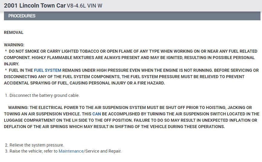

change fuel filter? I need to save money please help me

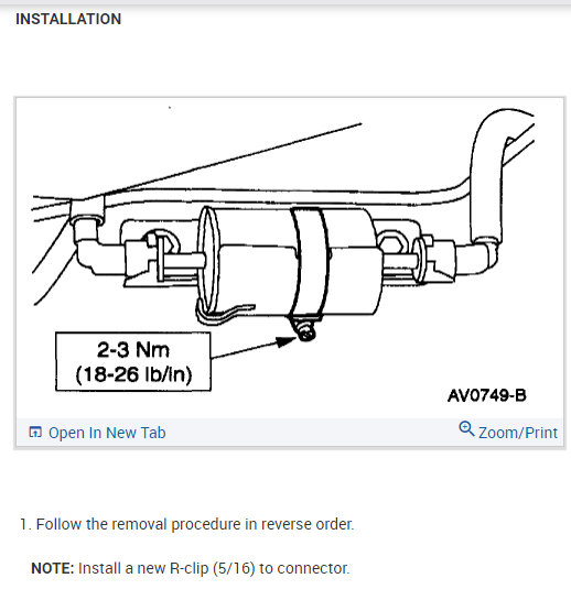

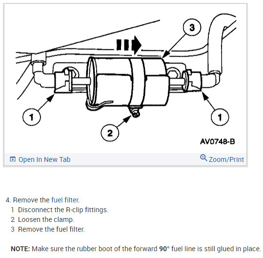

Here is the information you requested. Here is a guide to help you step by step with instructions in the diagrams below to show you how to perform the repairs on your car:
https://www.2carpros.com/articles/how-to-change-a-fuel-filter
I've attached picture steps below on how to change the fuel filter on your car. Hope this helps and thanks for using 2CarPros.
