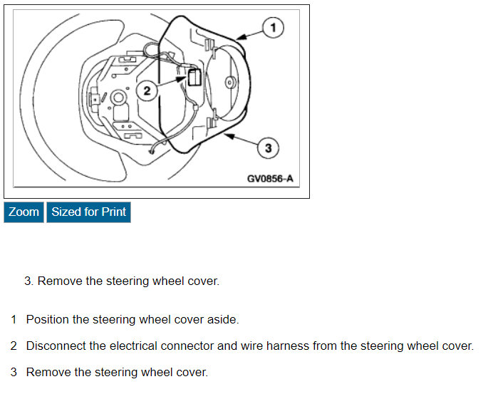

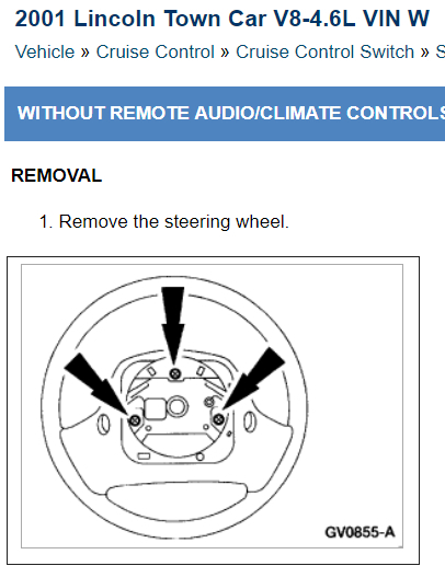

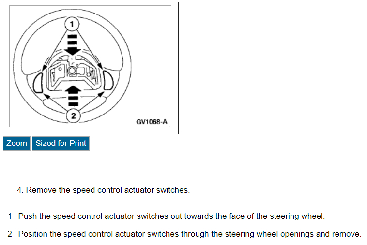

How do you replace the cruise control buttons on the steering wheel ?
Jul 24, 2008 at 12:55 PM
DJFINESSE80
  • 34 POSTS
Disconnect the battery first to disarm the airbag system. Here are diagrams to help you see how to replace the cruise control switches below.
