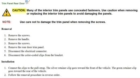

i would like to know how to remove rear inside door panel

https://images.2carpros.com/forum/automotive_pictures/261618_Noname_2547.jpg
Aug 5, 2010 at 7:22 PM
