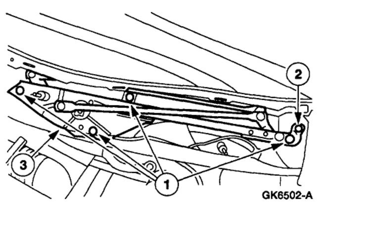

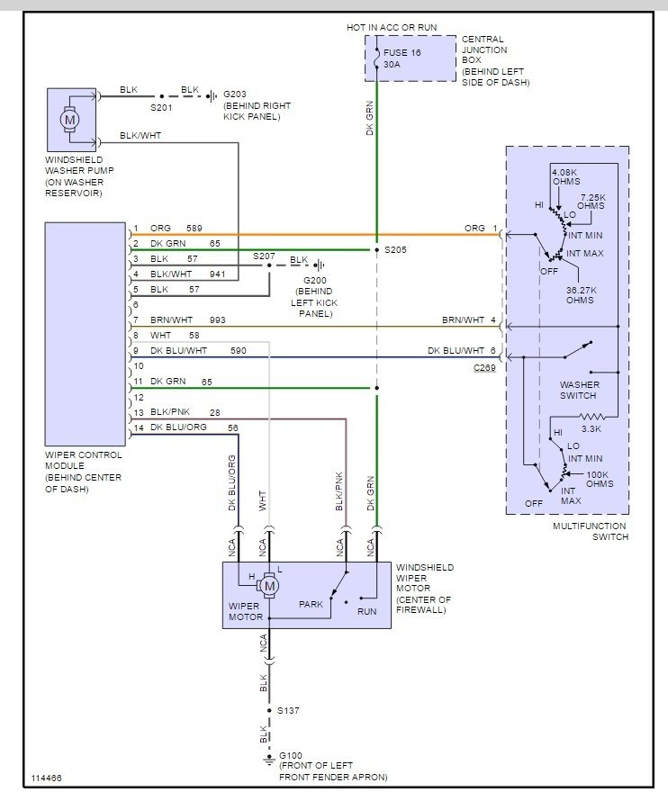

My wiper motor does not run, ever. No nothing.
The fuse that you told me to check, #16 is fine, and as I don't have a manual, I don't know where to start.
I know the wiper motor has been replaced before, but don't know when.

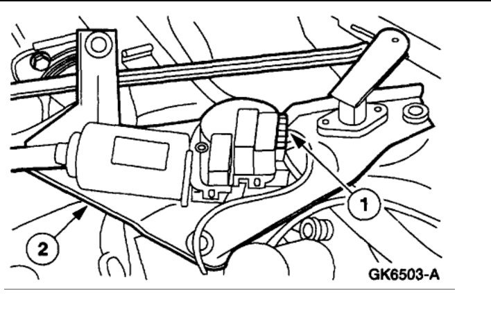

Is there an electrical connector I can ohm out to isolate the issue? The motor appears to be buried which seems to require pulling the wipers, the cover below the windshield, etc.

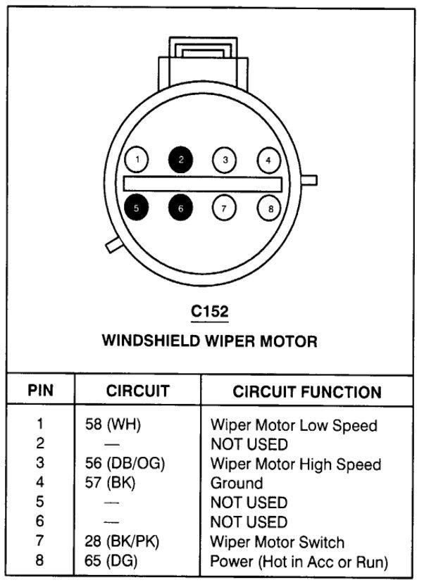

Gain access to the wiper motor
unplug and check for power
check for good ground at the wiper motor

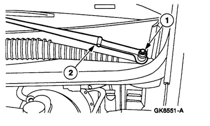

Hey Guys,
Begin by removing the wiper arms and plastic cover over the wipers. Test using a test light and use the guides below.
Please run some tests and get back to us so we can continue helping you.
Best, Ken
