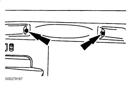

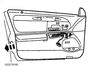

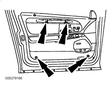

i need to know how to change my window motor in my car. Someone please help!
Sunday, May 17th, 2009 AT 10:42 PM
BMRFIXIT
  • 19,053 POSTS
Trim Panel Front Door
Removal
Remove the master window switch bezel.
Disconnect the connectors.
NOTE:Use care not to damage the trim panel when removing the screws.
Remove the screws.
Remove the handle.
Remove the screws.
Remove the front door trim panel.
Note the position of the color-coded clips and remove both clips from the bracket
Remove the inside weatherstrip.
CAUTION:Do not attempt to pry out the rivets as damage to the door window glass could result. Prior to removing the rivet center pins, it is necessary to place a suitable block support between the door outlet panel and the door window channel bracket to stabilize the door window glass during rivet removal.
Remove the rivets.
Remove the front door window glass.
NOTE:Install the front rivet before installing the rear rivet.
To install reverse the removal procedure
