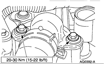

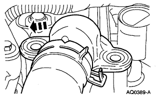

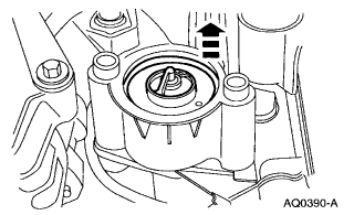

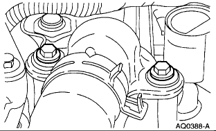

Hi joexray10, Welcome to 2carpros and TY for the donation Service and Repair REMOVAL CAUTION: Do not mix standard (green) coolant with Extended Life Coolant (orange). If this contamination occurs the service change interval on Extended Life Coolant will be reduced from 6 years/150,000 miles to 3 years/30,000 miles. Drain coolant below water thermostat.
https://images.2carpros.com/forum/automotive_pictures/12900_ts1_3.gif
Remove the screw and cover.
https://images.2carpros.com/forum/automotive_pictures/12900_ts2_2.gif
Remove the bolts from the water hose connection.
https://images.2carpros.com/forum/automotive_pictures/12900_ts3_1.gif
Position the water hose connection and the upper radiator hose out of the way.
https://images.2carpros.com/forum/automotive_pictures/12900_ts4_1.gif
Remove the water thermostat and the O-ring from the intake manifold. INSTALLATION
https://images.2carpros.com/forum/automotive_pictures/12900_ts5_1.gif
Follow the removal procedure in reverse order. Fill the cooling system.
