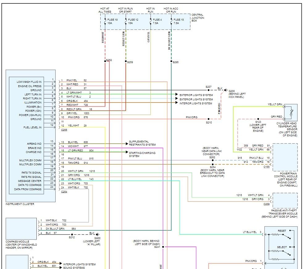

I recently had my oil changed and they replaced my oil sending switch because there was a leak. We tried 4 different switches, including one from the Ford dealership and all of them do not allow the oil light inside car to go out. The first three were from regular auto parts store but the last one was the actual part from the dealership. Lincoln dealership told me that I probably got a bad part but is it possible to get 4 bad parts in a row. Maybe the computer needs to be reset. Any help you can give me will be greatly appreciated. Many thanks.
P.S. I have attached a photo of the original part. All the new ones look totally different. [img:3ac73412e8]http://www.2carpros.com/forum/automotive_pictures/490306_oilSwitch_1.jpg[/img:3ac73412e8]

You need to check the oil pressure with a mechanical gauge-could be the oil pump is weak not producing the correct pressure

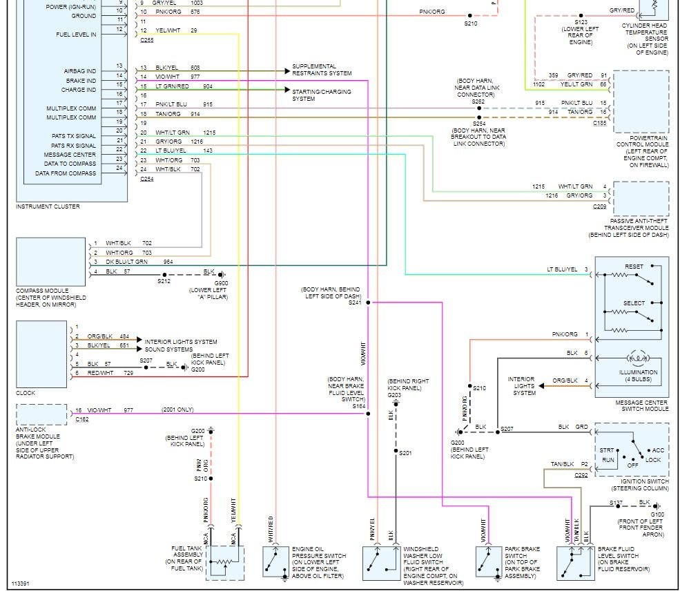

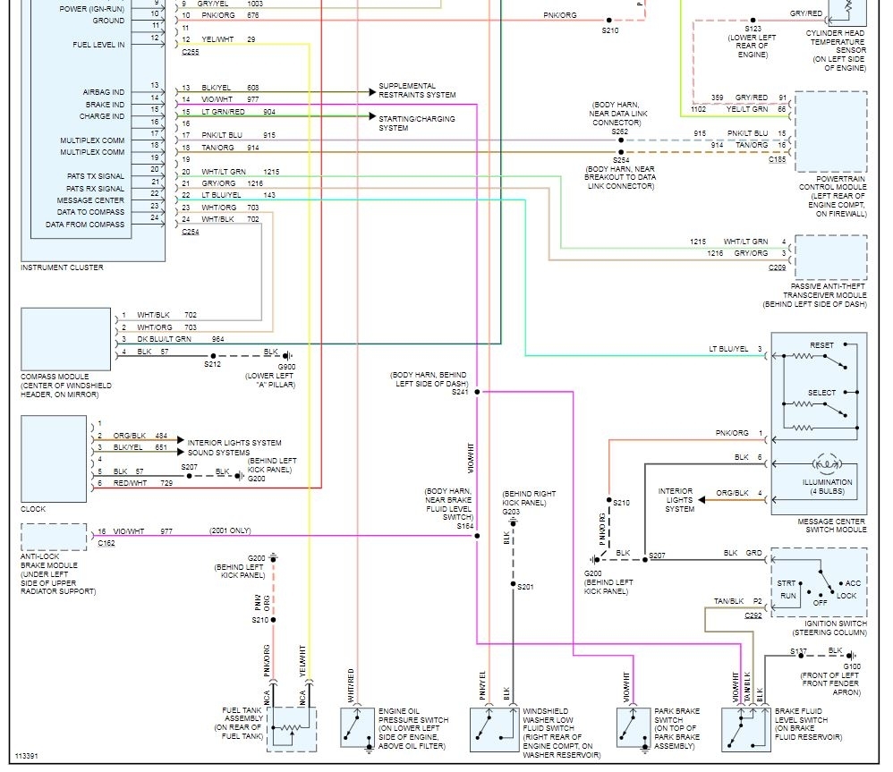

Oil Pressure Sender Oil Pressure Sending Unit The correct part number is sw-2220. E9sz-9278-a motorcraft part-Cross reference this OEM Part no. According to the wiring a 99 is a single wire switch, you should be able to test the new switches to see if they have continuity from the connector the the body of the switch, If so they are bad. Depending on the year, your car may need one from a 2000, you may want to see if there is a difference
Read the guide on using a meter below, it will help
Wiring diagrams of you instrument cluster/gauges are attached below
