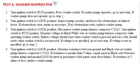

HILLBILLY585858
WHAT # IN THE FUSE BOX IS FOR THE WASHER / WINDOW

Hello I did not see a fuse for that though I am sure it runs through one of them. However, if you are no longer getting water, I have attached the troubleshooting for that. Most likely it is due to the washer pump needs replacing.
