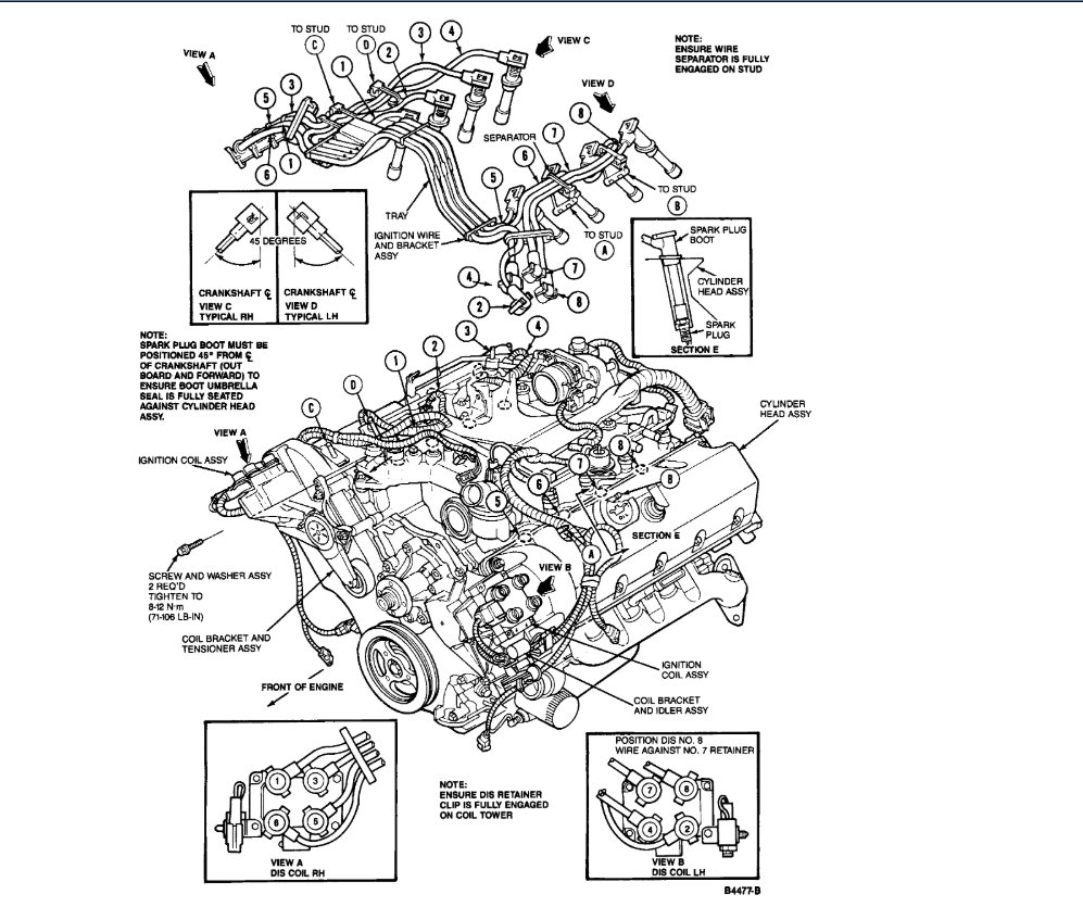

RATON99
Which cylinder is number 5 on 1999 lincoln town car
Aug 16, 2008 at 1:35 PM
OBXAUTOMEDIC
  • 3,711 POSTS
https://images.2carpros.com/forum/automotive_pictures/188069_99towncarfireordr_1.gif
Aug 16, 2008 at 2:37 PM

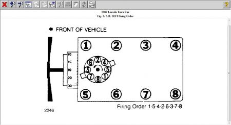

OUIMETTEJ
Engine Performance problem
1989 Lincoln Town Car V8 Two Wheel Drive Automatic
what is the proper firing order for the plug wires?
Which cylinder is the number one cylinder?
Jun 29, 2020 at 5:45 AM (Merged)
  • 75,992 POSTS
https://images.2carpros.com/forum/automotive_pictures/12900_lincoln_1.jpg

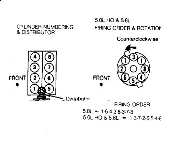

DOUG BAUER
What is the correct firing order for this vehicle? I seem to have placed new wires on new distributor cap incorrectly. Or is it possible that my failure to put dielectic grease on the new rotor tip would effect engine performance?
BLUELIGHTNIN6
  • 16,542 POSTS
You may need to try both in case you have a HO engine, which has a different firing order
https://images.2carpros.com/forum/automotive_pictures/261618_Graphic_347.jpg

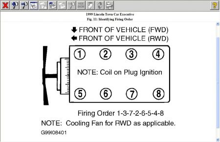

KEOSAVV
i am trying to replace the coils and wires on my car listed above but i can't seem to understand the function of the firing order. Can you give me a diagram or explain which wires go to what cylinder?
Dec 18, 2020 at 2:55 AM (Merged)
SCGRANTURISMO
  • 4,897 POSTS
I have included the information that you requested in the diagrams down below. I hope that this helps. Check out the diagrams (Below). Please let us know if you need anything else to get the problem fixed.
Thanks,
Alex
2CarPros
