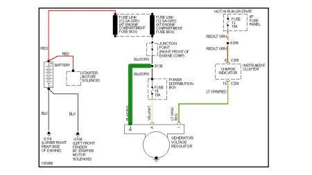

I have replaced the battery and have a new alternater (2nd one). Yet the battery won't recharge. The wiring appeares O.K., and I was told to check fuses. I don't know what fuses to check, or where they are located. Thanks, Lee

Check fuse 19 in the power distribution box and fuse 12 in instrument fuse panel.
https://images.2carpros.com/forum/automotive_pictures/12900_98_alty_1.jpg
