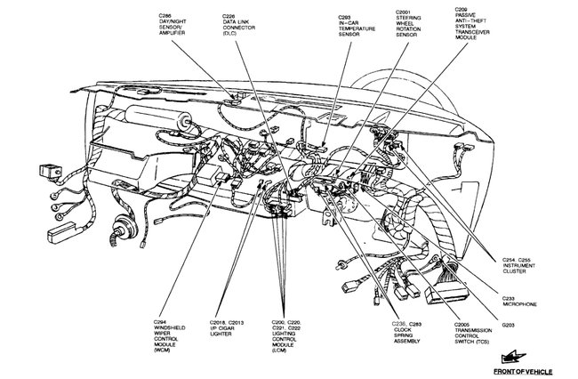

There is a lighting control module that sound like it may have gone out, here is a wiring diagram for the blinkers that you can use for some testing and a guide to show you how. Here is the location of the lighting module so you can change it out:
Please run some tests and get back to us so we can continue helping you.Check out the diagrams (below). Please run this test and get back to us.

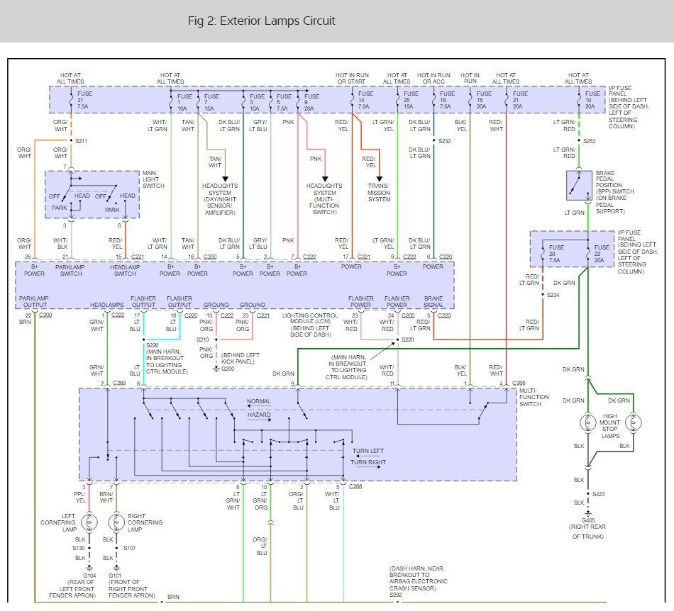

I received a schematic but there is no way for me to read it. Please send a larger jpg schematic I read in Paint. Thanks Bill
Apr 16, 2020 at 3:48 AM (Merged)
MIKE H R
  • 3,094 POSTS

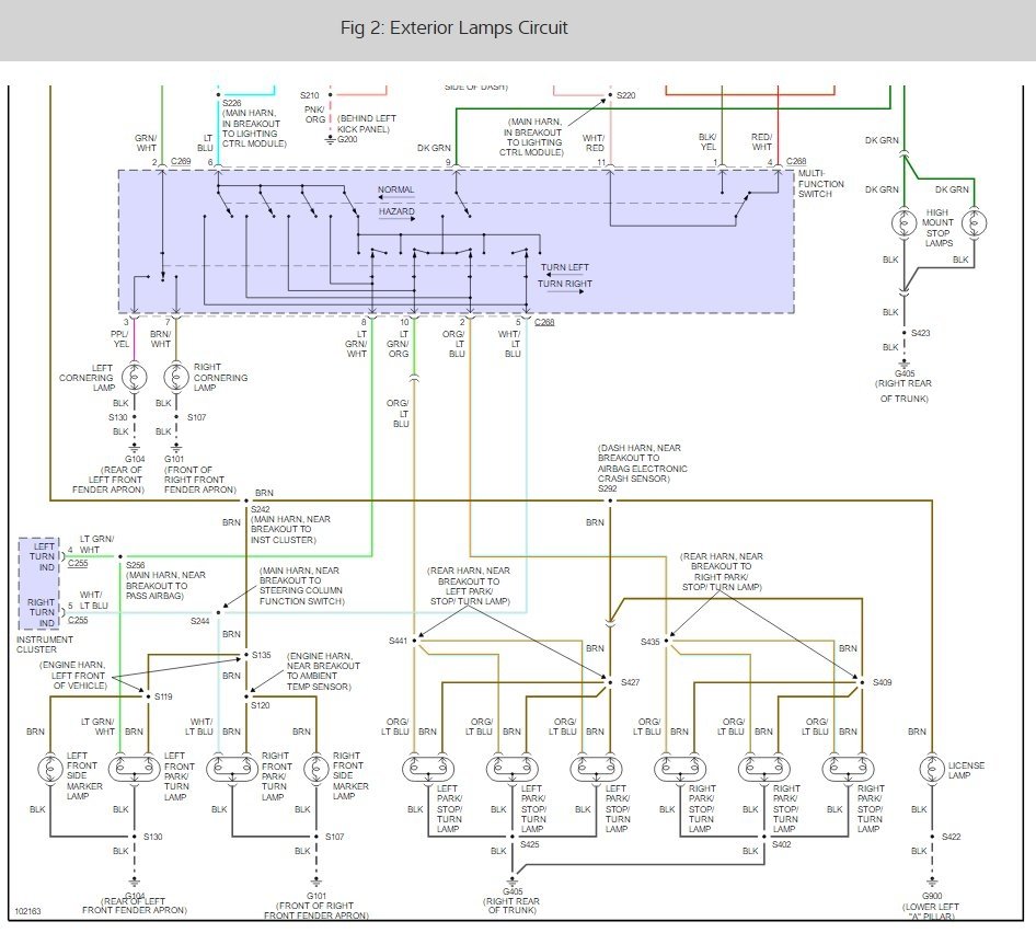

here is a diagram of the exterior lights including the signal lights. Sometimes the diagrams don't come out right. If not save it to your pictures then you can enlarge it. What it sounds like is there is a break in the power to the signals. the multi function switch could be bad.
https://images.2carpros.com/forum/automotive_pictures/54223_lincoln_town_car_exterior_lights_1.jpg
MLAWSON
I had a bad turn signal switch fixed my car I took it to my mechanic that's what he said was wrong.
