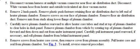

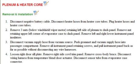

I am looking at a 97 TownCar that has a heater core bypass. It is summer now and I am not concerned about the heater at this time, however, is this a big problem or a nuisance problem?

If the heater core is bypassed, this is usually due to a faulty heater core and not having it properly replaced. Below are the proper replacement procedures for your vehicle's heater core..
https://images.2carpros.com/forum/automotive_pictures/261618_Noname_552.jpg
https://images.2carpros.com/forum/automotive_pictures/261618_Noname2_139.jpg
