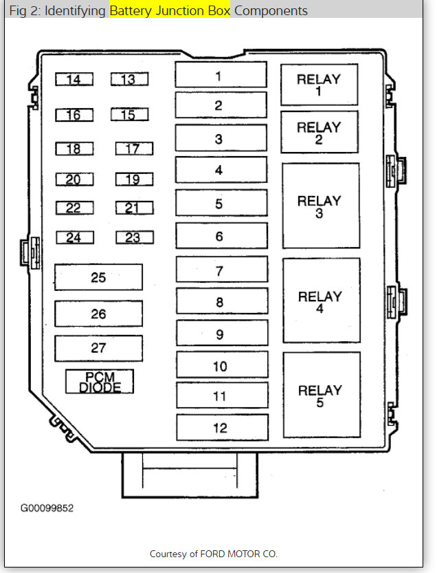

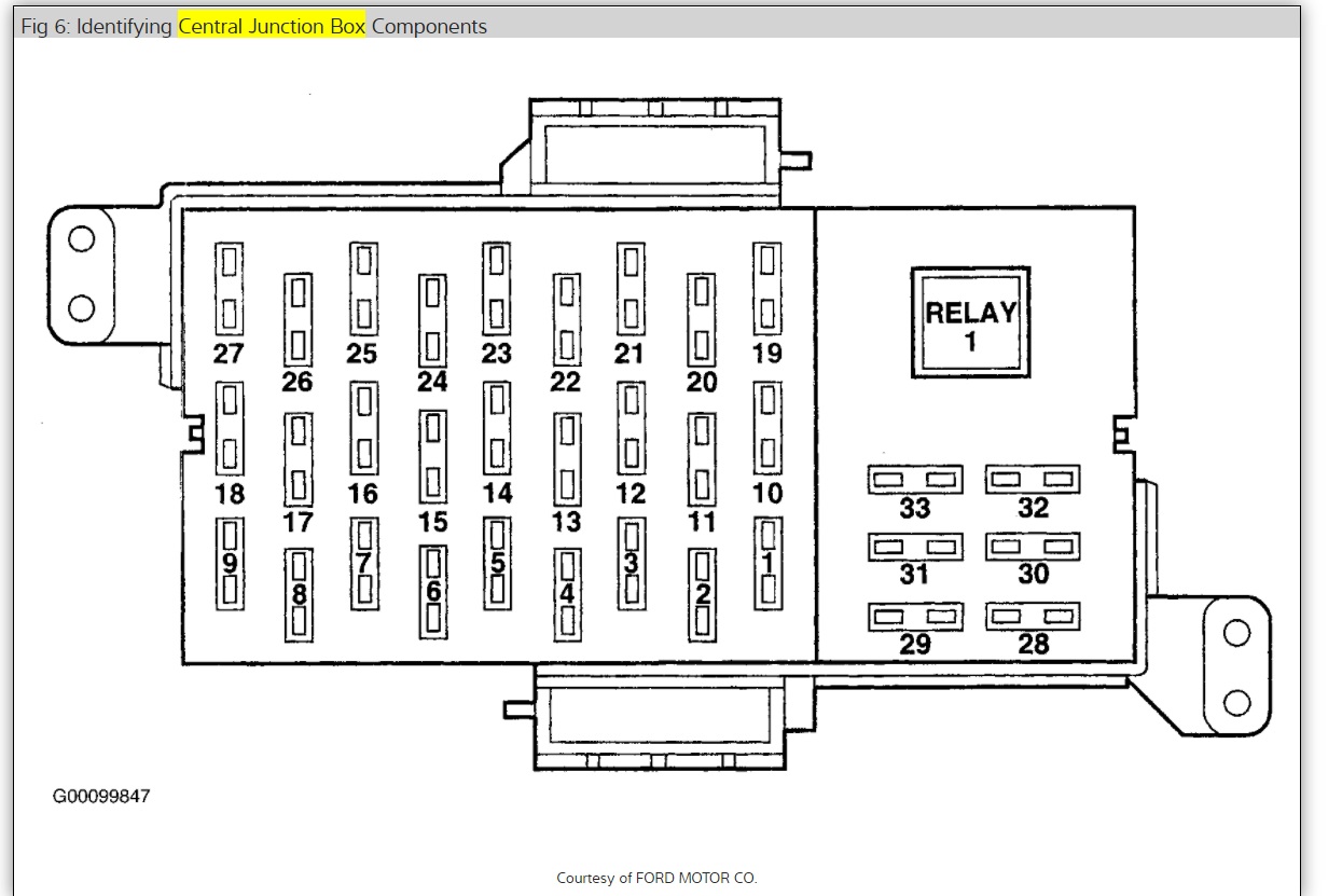

Which fuse controls the dash board lights? I need the fuse panel diagrams please.
Jim
Jan 11, 2010 at 6:16 PM
DOCFIXIT
  • 18,828 POSTS
No 15 fuse is I/P illumination see diagram
https://images.2carpros.com/forum/automotive_pictures/198357_Graphic_326.jpg

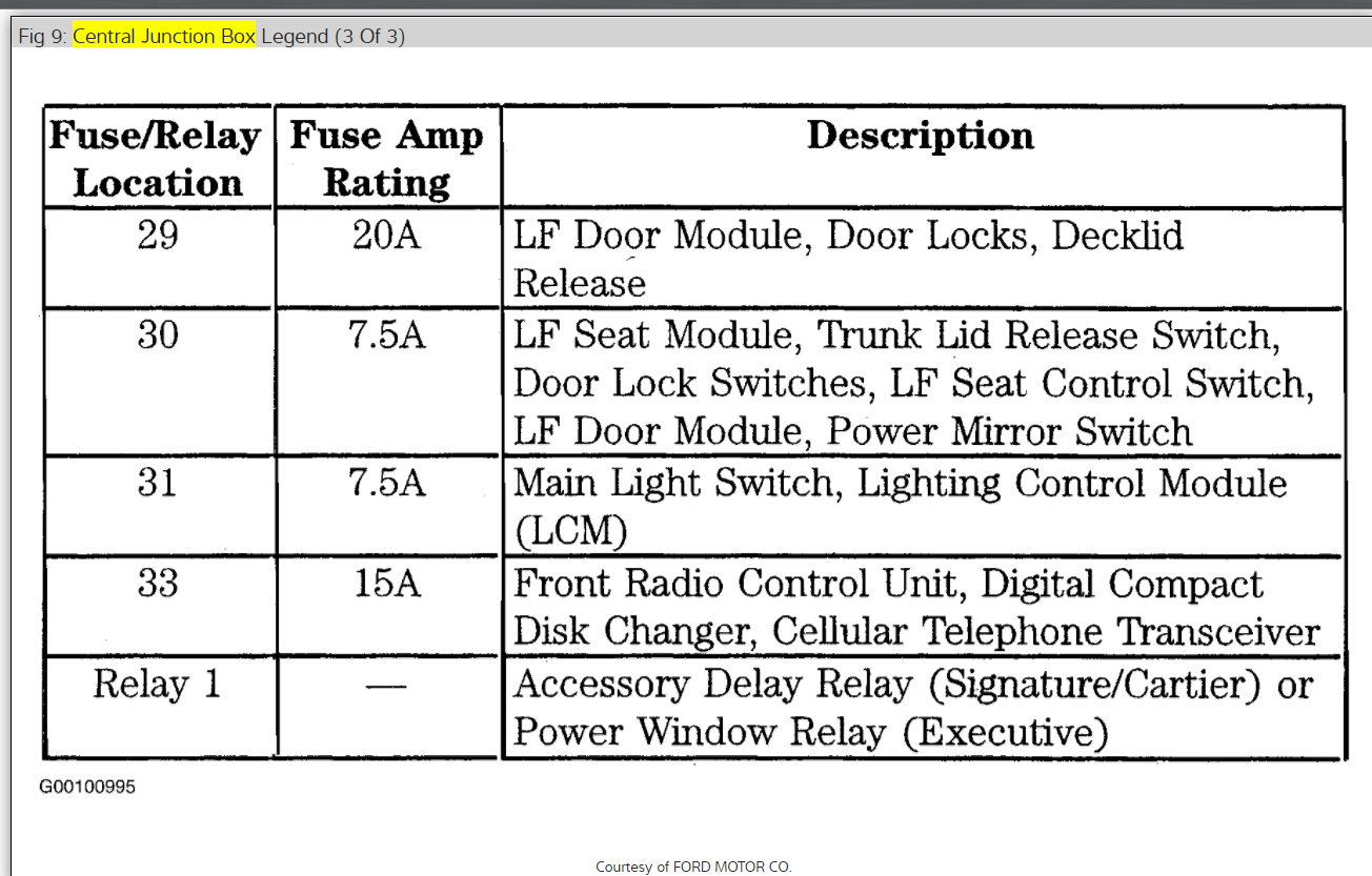

Fuse & Circuit Breaker Identification 1 - 15 Amp Backup Lamps, Turn Signal Lamps, Electronic Automatic Temperature Control (EATC) Module, Brake Shift Lock Solenoid, Heated Seat 2 - 30 Amp Wiper/Washer Control Module, Windshield Wiper Motor 3 - 5 Amp Alternator Motor 4 - 10 Amp Lighting Control Module 5 - 15 Amp Ignition Coils, Powertrain Control Module (PCM) Power Relay 6 - 10 Amp Front Radio Control Unit, Clock, Cellular Phone, Compass Module, Lighting Control Module (LCM), Electronic Day/Night Mirror 7 - 15 Amp Air Bags Diagnostic Monitor, Anti-Lock Brake Module, Instrument Cluster, Speed Control Amplifier, Air Suspension/EVO Steering Module, Transmission Control Switch, Warning Indicators, Steering Wheel Rotation Sensor, Electronic Automatic Temperature Control (EATC) Module, Daytime Running Lamps 8 - 15 Amp Trunk Lid Pull Down, CD Changer, Power Mirrors, Keyless Entry, Memory Seats, Redundant Steering Control Module, Cellular Phone 9 - 5 Amp Front Radio Control Unit, Air Bag Diagnostic Module, Lighting Control Module (LCM), Warning Indicators 10 - 30 Amp Electronic Automatic Temperature Control (EATC) Module 11 - 5 Amp Left Front Seat Module, Left Front Door Module 12 - 18 Amp Circuit Breaker Headlamps, Lighting Control Module 13 - 10 Amp Rear Window Defrost/Heated Mirror 14 - 20 Amp Circuit Breaker Keyless Entry, Power Seats, Fuel Fill Door Release, Left Front Seat Module, Left Front Door Module 15 - 15 Amp Courtesy Lamps, Lighting Control Module (LCM), Daytime Running Lamps, Instrument Panel Illumination 16 - 15 Amp Brake ON/OFF Switch, Hazard Flashers, Brake Pressure Switch 17 - 20 Amp Cigar Lighter, Power Point 18 - 10 Amp Instrument Cluster, Clock, Front Radio Control Unit, Electronic Automatic Temperature Control (EATC) Module, On Board Diagnostic (OBD) Data Link Connector
Jan 12, 2010 at 10:56 AM
  • 54,853 POSTS

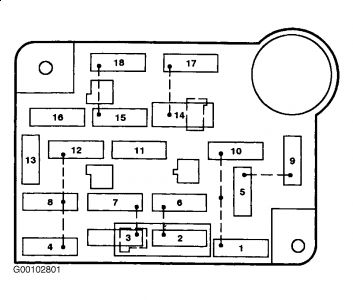

Here are more fuse panel diagrams (below) Please let us know if you need anything else to get the problem fixed.
