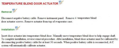

My AC was working great, then one day a heard a sort of flapping noise from under the glove box, and then Hot (not warm but Hot) air began blowing through the vents. I'm sure the Actuator for the blend Door is shot, or the linkage. I suspect I will need to pull the dash to replace the 70 dollar part. I know the AC is still charged.

would you like replacement instructions for your vehicle's actuator?

yes, that would be most helpful.

https://images.2carpros.com/forum/automotive_pictures/261618_Noname_1053.jpg
