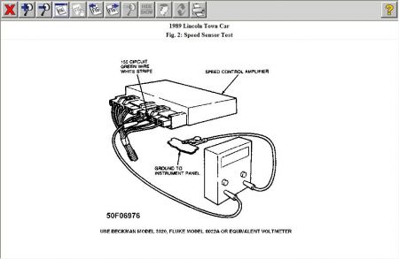

SUPERC
When driving the car the cruise control performs perfectly. However, once I stop the car and turn the engine off, when I restart and resume driving the cruise control will not stay engaged.
Dec 10, 2018 at 11:29 AM (Merged)
  • 75,992 POSTS
Get the speed control amplifier and speed sensor checked/get a read out from the cruise control computer for further diagnosis.
