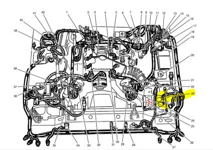

THERE ARE NO CODES AND WHERE DO I FIND THE MOTOR FOR THE SUSPENSION.
MY REPAIR MANUAL DOES NOT SHOW OR TELL WHERE IT IS.

need to use a scanner tool for codes an OBDII reader will not get you any codes from the air suspension system
https://images.2carpros.com/forum/automotive_pictures/99387_7005_thumbnail_12.jpg
