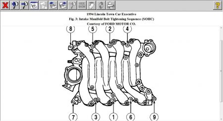

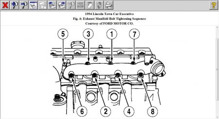

1994 Lincoln Town Car torque for intake manifold bolt
1994 LINCOLN TOWN CAR
210,223 MILES • V8 • 2WD • AUTOMATIC
OTTOMAN1
I wanted to find what torque per pound I needed to apply
Aug 10, 2010 at 8:21 PM
  • 75,992 POSTS
Intake Manifold Bolt 15-22ft lbs Tighten bolts in sequence.
