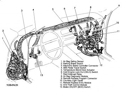

I would like to reprogram my keyless entry keypad, I need the factory code off the control module for the keyless entry system. Where is the keyless entry system control module location on a 1994 Lincoln Town Car?

Your vehicle's remote keyless entry module is located behind the right kick panel, behind insulator..
https://www.2carpros.com/forum/automotive_pictures/261618_Graphic_439.jpg
