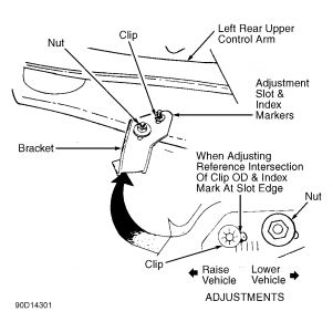

Normally my air ride works fine, every once in a while the light will come on, the pump stops, or something, I just shut the car off and turn it on again and the light goes off and the pump turns on again.
I jacked the front of the car to change the oil and didnt shut the swith off in the trunk, now the rear end is all the way down. I hear the pump on for about ten minutes but then shuts off unless I keep turning off the car and turning it back on but it still only runs for a few minutes, the rear end wont come up. I tried driving it with frequent stops and starts, but it will not come up. What about jacking it up and letting the weight off each side with car stands or something. Any ideas.

Most common the ride height sensor what happen the rod falls out check that and let me know good luck need manual CHECK IT @ http://www.2carpros.com/kpages/auto_repair_manuals.htm
https://images.2carpros.com/forum/automotive_pictures/99387_Graphic1_61.jpg
