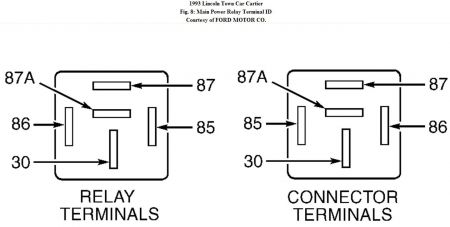

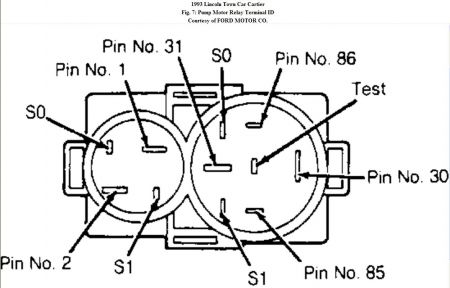

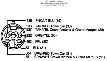

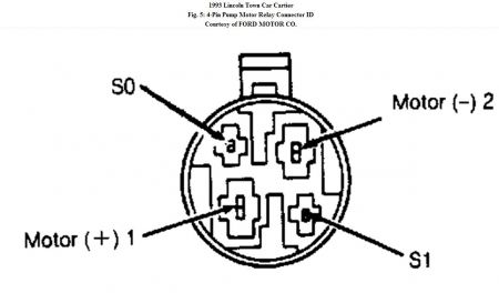

BLEEDING BRAKE SYSTEM 1. Unplug ECU 55-pin connector. ECU is located in engine compartment, under upper radiator support. Install Breakout Box (014-00322) and ABS Adapter (T90P-50-ALA). Set BLEEDER/HARNESS switch to BLEED position. Set ignition switch to ON position. Red OFF indicator light will glow. 2. Press MOTOR button on adapter. Pump motor will run. Red indicator light will go out, and Green ON indicator will glow. Pump will run for 60 seconds. If pump motor is to be turned off before 60 seconds has elapsed, press ABORT button. 3. After pump motor runs for 20 seconds, press and hold VALVE button for 20 seconds, then release. Pump will continue to run for an additional 20 seconds. The brakes may now be bled in the conventional manner using the following sequence: right rear, left front, left rear, and right front. CAUTION: The anti-lock brake system must be bled using the following procedure. If this procedure is not followed, air will be trapped in the Hydraulic Control Unit (HCU), resulting in a spongy pedal.
First thing you need to do is have the codes read, it will pinpoint the problem, but, check the wheel speed sensor wires for damage that might have occurred during air spring removal., these the wires, use an ohm meter, reading at sensor connector is 800-1400 omhs.
May 30, 2010 at 8:52 AM
MERLIN2021
  • 17,250 POSTS

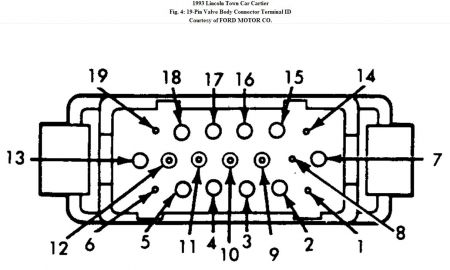

PINPOINT TEST BB - SOLENOID VALVE DIAGNOSIS 1. Code 17 Or 22 Unplug ECU 55-pin connector. Connect breakout box and adapter. Connect jumper wire between breakout box pins No. 19 and No. 34. Measure voltage between pins No. 3 and No. 60. If voltage is at least 10 volts, go to step 2). If voltage is less than 10 volts, repair circuit No. 532 (Orange/Yellow wire), No. 533 (Tan/Red wire) or No. 603 (Dark Green wire) on Town Car, or circuit No. 532 (Orange/Yellow wire), No. 537 (Tan/Yellow wire) or No. 603 (Dark Green wire) on Crown Victoria and Grand Marquis. 2. Measure resistance between breakout box pins No. 3 and No. 20. If resistance is 5-8 ohms, read service codes again. If other codes exist, disregard Code 17 or 22, and service other code (s). If resistance is not 5-8 ohms, go to next step. 3. Unplug valve body 19-pin connector. Measure resistance between pins No. 7 and No. 17. See Fig. 4 . If resistance is 5-8 ohms, repair circuit No. 495 (Tan wire). If resistance is not 5-8 ohms, replace valve body.
