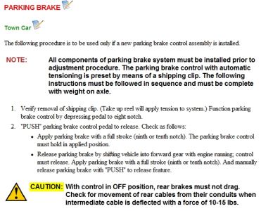

how to adjust
Apr 6, 2010 at 4:48 AM
BLUELIGHTNIN6
  • 16,542 POSTS
https://images.2carpros.com/forum/automotive_pictures/261618_Noname_2036.jpg
