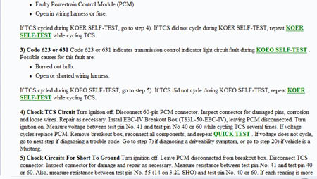

i recieved a code 632- transmission control switch circuit did not change states during koer self-test, where do i go from here?
Feb 22, 2008 at 3:31 PM
MERLIN2021
  • 17,250 POSTS

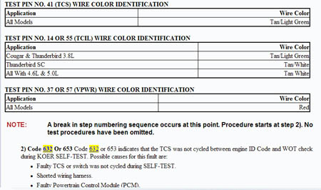

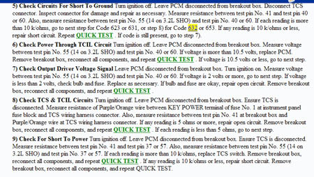

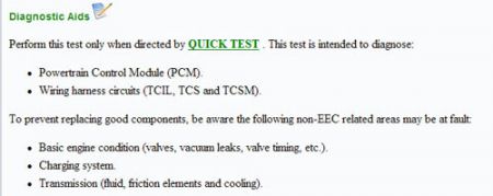

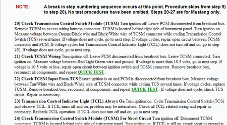

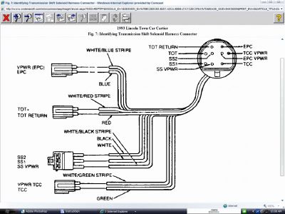

Here are the testing proceedures...Possibly the WOT test was not done right?
https://images.2carpros.com/forum/automotive_pictures/62217_632a_1.jpg
https://images.2carpros.com/forum/automotive_pictures/62217_632b_1.jpg
https://images.2carpros.com/forum/automotive_pictures/62217_632c_1.jpg
https://images.2carpros.com/forum/automotive_pictures/62217_632d_1.jpg
https://images.2carpros.com/forum/automotive_pictures/62217_632e_1.jpg
https://images.2carpros.com/forum/automotive_pictures/62217_632f_1.jpg
