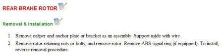

how do you remove the rear rotors from a 1991 lincoln towncar? i removed the brakes and tried to take off the rotors but they would not move at all. is there somes screws that have to be removed first?..thanks..

If rotors seem stuck, try pecking on them with small rubber headed mallet / hammer.
https://images.2carpros.com/forum/automotive_pictures/261618_Noname_557.jpg
