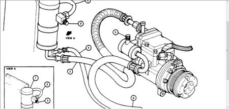

Air Conditioning problem
1990 Lincoln Town Car V8 Four Wheel Drive Automatic
I wanted to know where to find the side sevice port so that I can put the Refrigerant in to the car. I saw a red tab on one spot and a blue tab in a different spot. I cant find any thing in the book for the car about the AC. please help me it is hot out here,

The low side is on no.3 see below
https://images.2carpros.com/forum/automotive_pictures/12900_ac_10.jpg
