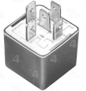

Sorry, I need to ask one more question. The plastic cover of the fuse box gives the location of each numbered fuse. But in the fuse #2 slot is a large metal covered insert. I don't know if this is the way the fuse is supposed to look, or if someone put something in that is permament. I tried pulling it out gently, and it won't budge. I don't want to break it. Is this fuse #2 supposed to be much, much larger than the other fuses and metal instead of plastic? Is it safe to pull hard? (I'm a novice, as you can see)
Thanks very much!
Mar 30, 2010 at 8:33 PM
BLUELIGHTNIN6
  • 16,542 POSTS
does it look like the pic below? if so then its fine, its just a relay instead of regular fuse, still pull it out the same. more prongs on it so may be little tighter..

It has a similar metal cover, but it is long and narrow instead of square. I don't know if it has prongs--I'd have to pull it out to see. Should I try to pull it out? I just want to make sure I don't damage anything.
Thanks!
Mar 31, 2010 at 9:29 AM
BLUELIGHTNIN6
  • 16,542 POSTS
yep pull it out
