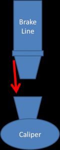

When they rebuilt them, they may not have re-cut the threads……thus, the leak.
I don’t think they would get loose or be loose though………I “think” they are shaped below so the more you tighten it automatically gets tighter……..
Well, I don’t think Loc-Tite would help since it is so thin unlike say, pipe putty, but it may take up enough room between the threads to stop it.

When they rebuilt them, they may not have re-cut the threads......thus, the leak. I don't think they would get loose or be loose though.........I "think" they are shaped below so the more you tighten it automatically gets tighter........

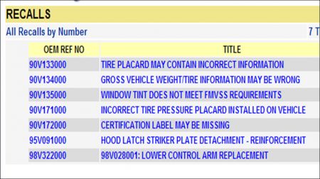

Well, I don't think Loc-Tite would help since it is so thin unlike say, pipe putty, but it may take up enough room between the threads to stop it. I had one a couple of years ago I had to take back and get a new, not rebuilt. I even had new brake hoses.........it still had a small leak.........so took back and got the new.......the other side worked fine. My suggestion is to try it...........well, I would try it first w/o the crush washer.....I just don't like any leaks on the old brakes though...... Now the crush washer doesn't have a recess on one side does it???? Okay, not sure if I have helped..........if the threads are pulled........you may need to get another set............. Let me know what you do please............. Also, I realize this may have already been repaired, but you may have some recalls on your vehicle. The dealer may fix these for free. Please contact the dealer service department, give them the VIN number of your car and have them check on these to see if they apply to you.
