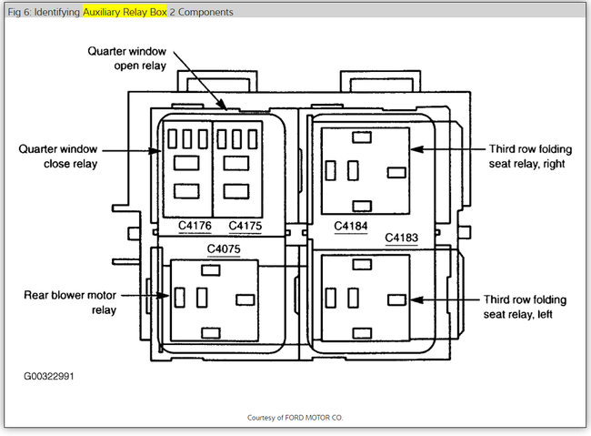

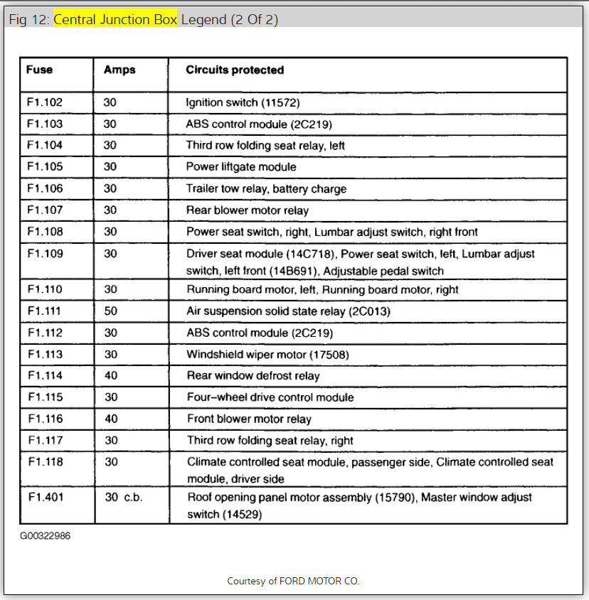

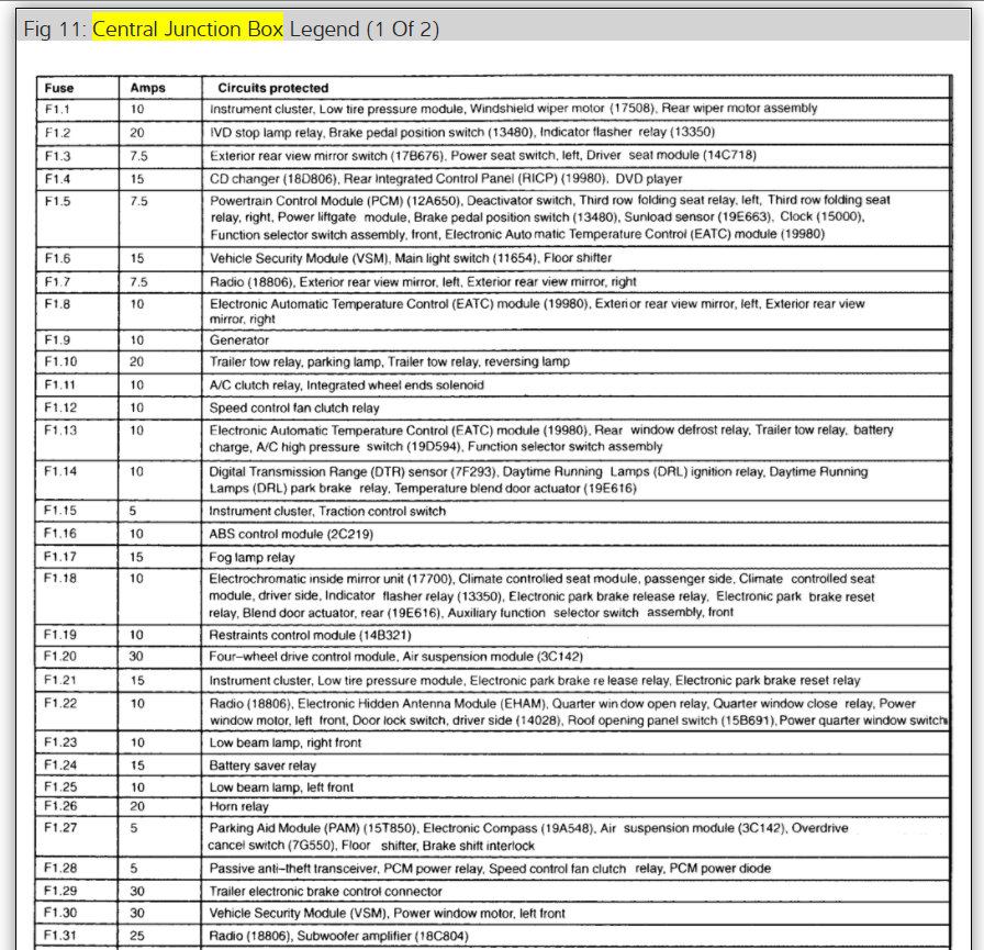

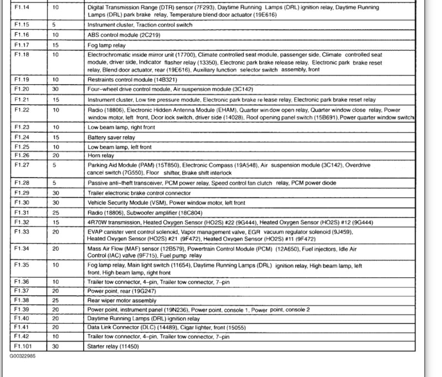

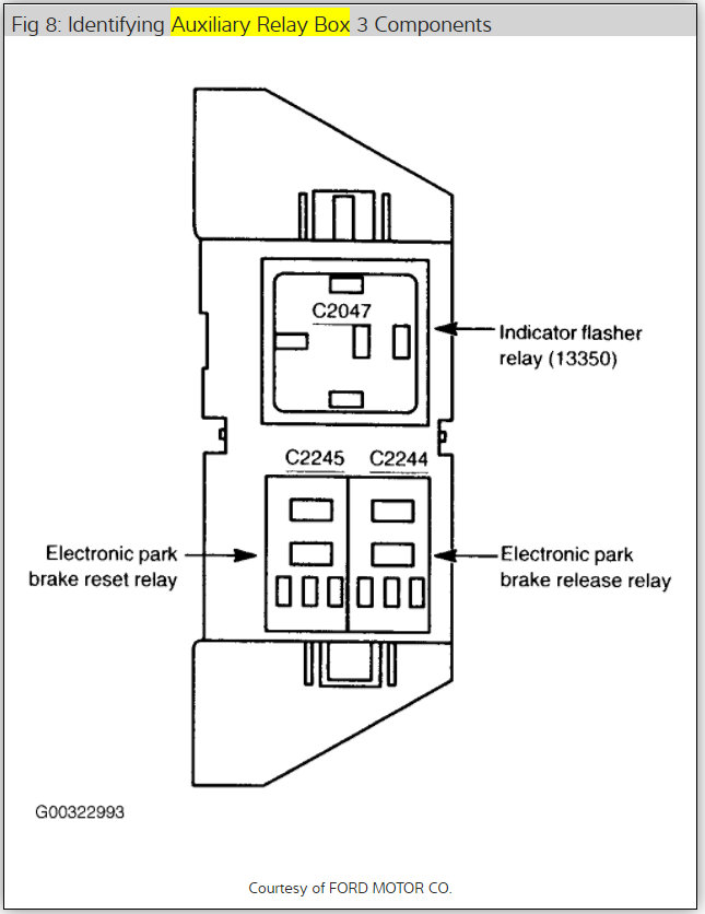

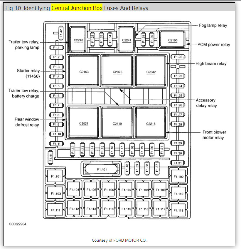

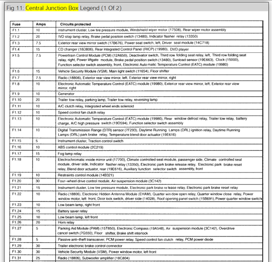

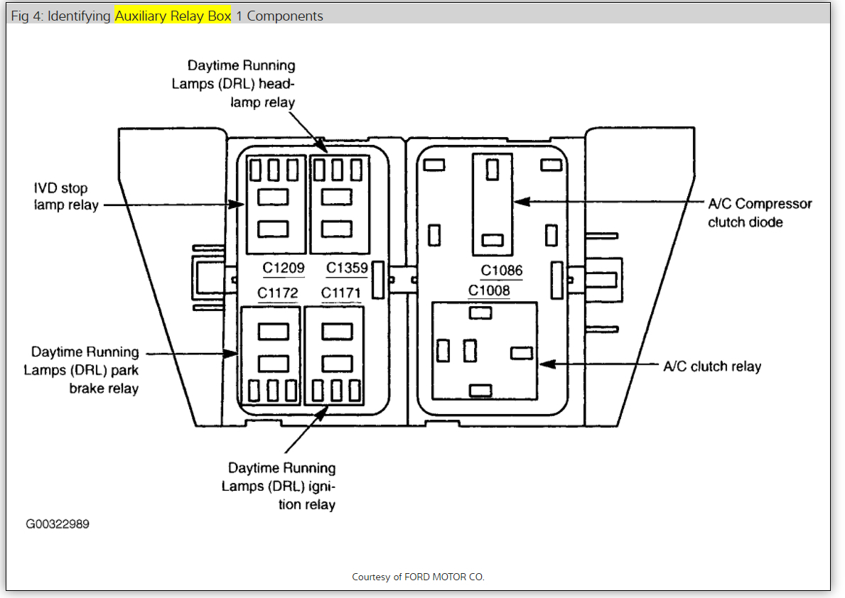

Where is the fuse panel? Can you provide a picture of what the panel looks like?
Jun 20, 2008 at 5:03 PM
MATTHEW1GUERRA
  • 5 POSTS
Here are two guides to help you check the fuses and the relays along with the fuse panel and relay panels for both under the hood and passengers compartments.
and
