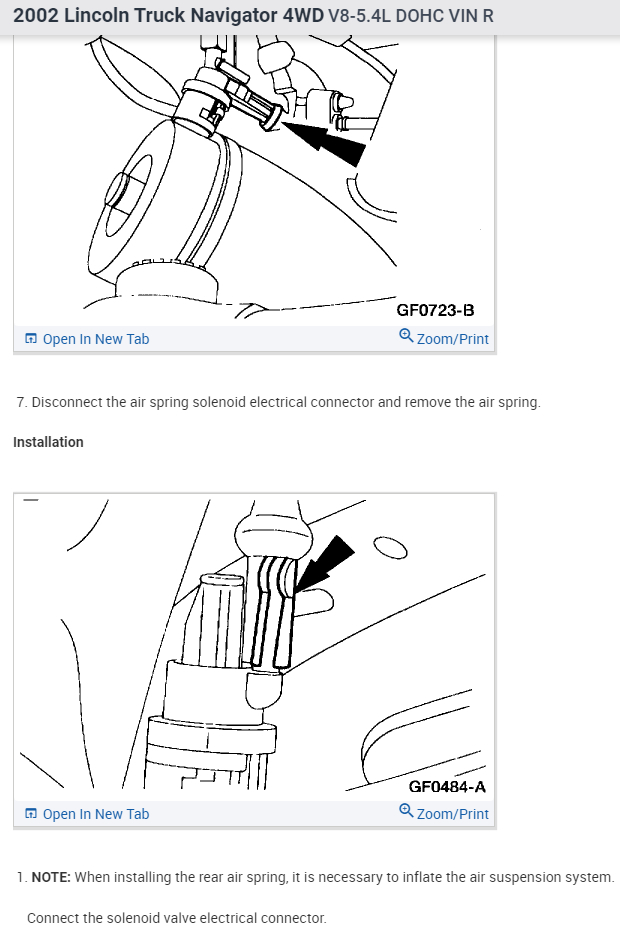

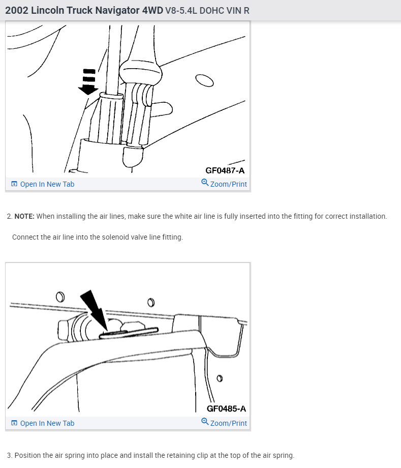

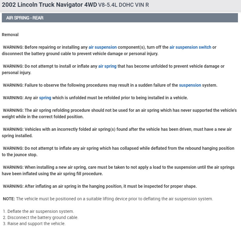

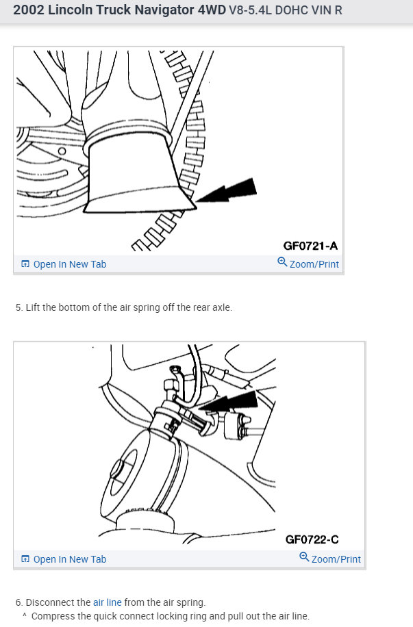

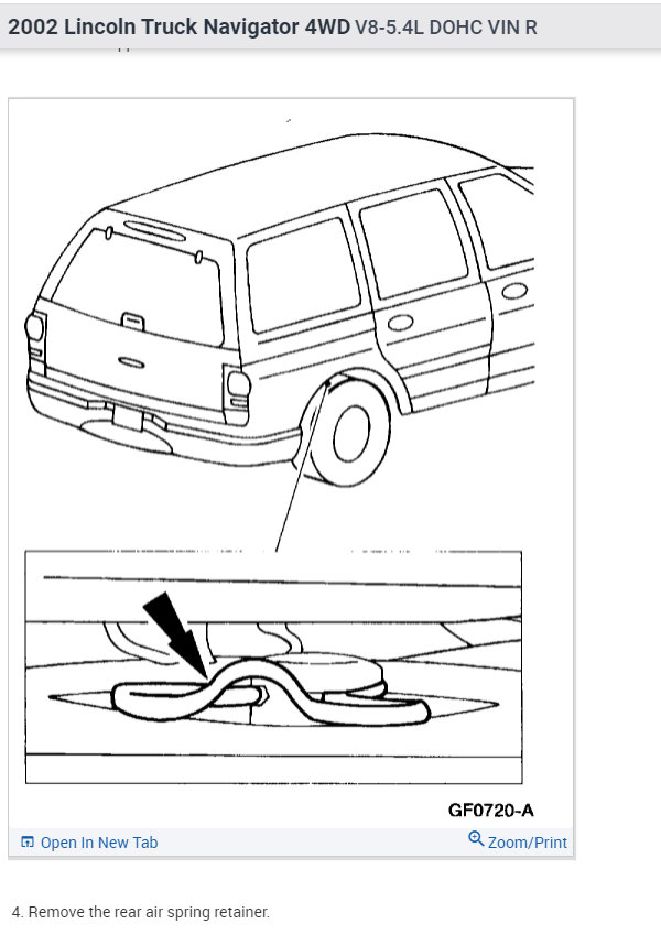

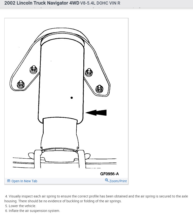

Converting the air springs to conventional setup can save on cost and extra complexities. Keep in mind that the ride quality will be different with a conversion.
I have attached the factory air spring replacement procedure, for anyone who might be looking for those instructions.
