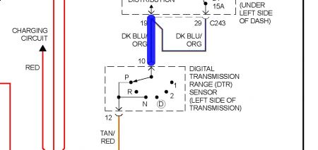

Where is the neutral safety switch located I have the column down and don't see it I took the cover off the steering wheel and nothing either they gave me the wrong one or I am not seeing it please help its cold in colorado

What you're looking for is the transmission range sensor located on the left side of the transmission.
https://images.2carpros.com/forum/automotive_pictures/12900_TRS_1.jpg
