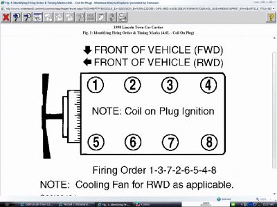

How do I find out what numbers my spark plugs are I pluged it into a machine and it told me that number 1 and 8 are misfiring and well I bought the wires I need and I need to know which ones are number 1 and 8. I have changed all the plugs. just need to find out where is 1 and 8 Thanks ???

Are you saying you are replacing only 2 out of eight plugs? Looking for more trouble?
https://images.2carpros.com/forum/automotive_pictures/62217_Firing_Order_3.jpg
