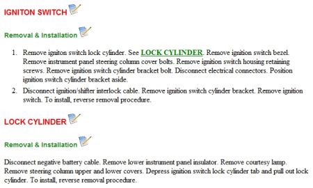

how do i remove the ignition switch from a 1998 lincoln mark viii is there a video? or pic's

https://images.2carpros.com/forum/automotive_pictures/261618_Noname_1902.jpg
