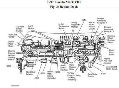

my interior lights stay on after entering my vehicle
Apr 5, 2010 at 12:33 AM
  • 55,432 POSTS
Hello, Do the lights stay on all the time or just after you enter in the vehicle?
Apr 7, 2010 at 10:51 AM
MONTERAY
they stay on continually whereas they used to shut down after a min.are so.
Apr 8, 2010 at 3:51 AM
  • 55,432 POSTS
Did you check the interior light switch near/on the headlight switch, sometimes they can be engaged without you knowing it. Please inspect and get back to me so we can continue.
Apr 8, 2010 at 6:07 AM
MONTERAY
I did check the switch it used to come on when you entered the car then slowly shut down as if on a timer are relay but now it continously stays on never shutting off evn aftr the car has been shut off.I does shut off after a period of time when the car is setting over night.
Apr 9, 2010 at 2:03 AM
  • 55,432 POSTS
The interior lights are controlled by the BCM body control module. This module sounds like is it malfunctioning causing your problem. Unfortunately the only way to check it is by replacement.
Apr 9, 2010 at 4:36 AM
MONTERAY
Is that under the hood in the box on the drivers side?
Apr 9, 2010 at 7:26 AM
  • 55,432 POSTS
The lighting moduel is under the dash lower right side. I have attached an image. Please let me know how it goes.
