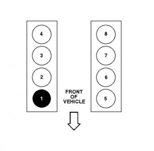

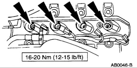

just purchased this vehicle. scanner says that #8 cylinder is missing. how do I correct this. i can't find the spark plugs or wires to replace.

Check spark plug,compression and fuel injector on #8 cylinder.
https://images.2carpros.com/forum/automotive_pictures/12900_s1_65.jpg
https://images.2carpros.com/forum/automotive_pictures/12900_s_23.jpg
Firing Order 1-3-7-2-6-5-4-8 Coil On Plug
