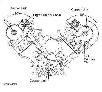

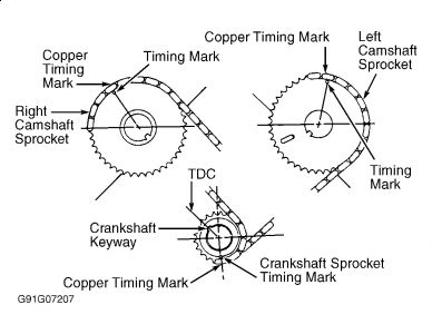

i recently had the heads shaved on 97 mark viii 4.6 dohc 32 valve,
and before they shaved them they took my cams off and
didnt mark them and i was wondering if anybody could
tell me how to get them back in time?
Apr 16, 2009 at 5:08 PM
RACEFAN966
  • 5,029 POSTS
Here are some pics of the timing marks for you I hope this is what you are looking for. If there is anything more you need just ask ok.
https://images.2carpros.com/forum/automotive_pictures/249564_Graphic_71.jpg
https://images.2carpros.com/forum/automotive_pictures/249564_graphic1_2.jpg
