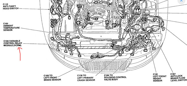

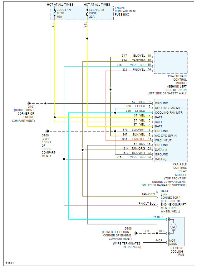

I have made a small donation. The cooling fan will not work. Here is what I have done up to this point. Hot wired fan to batt, It worked, Put on another muti purpose switch, Located in front of raidiator. crossed sensor located on manifold top left, did not work, no voltage with plug in, unplug and voltage.

Check the cooling fan relay or water temperature switch.

Nope that is not the problem RASMATAZ, these cars had a problem with the variable control module (VCRM) which is located on the radiator support, here is the cooling fan wiring diagrams so you can see how the system works. Check out the images (below). Let us know if you need anything else.
