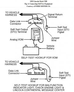

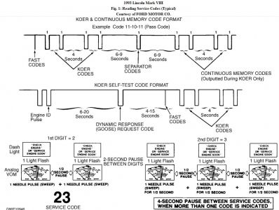

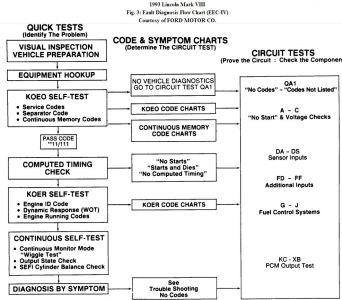

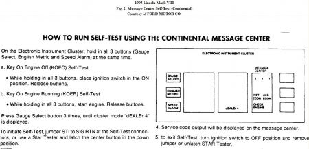

If the check engine light is on read the codes, this is always the first step, here's how, Post all codes found, and I will tell you what's next. READING CODES KOEO & KOER SELF-TEST Codes PCM outputs codes one digit at a time. Record codes in order received. These codes indicate current faults in system and should be serviced in order of appearance. Use SERVICE CODE-TO-TEST MENUS to find correct CIRCUIT TEST. If using VOM, pay careful attention to length of pauses in order to read codes correctly. A 1/2-second pause occurs between number of sweeps in a digit. A 2-second pause occurs between digits in a code. A 4-second pause occurs between each code. KOEO codes are separated from Continuous Memory codes by a 6-second delay, a 1/2-second sweep (separator) and another 6-second delay. See Fig. 1. If using MIL/CHECK ENGINE light, service codes are displayed as flashes. On Continental, message center may be used to display codes. See Fig. 2. Scan tester, if used, will count pulses and display them as a digital code. STAR Series Tester will add a zero (0) to single-digit Separator Code (10) and Dynamic Response Code (10). Dynamic Response Code is displayed in KOER SELF-TEST. See Fig. 1. Separator Pulse Single 1/2-second separator pulse is issued 6-9 seconds after last KOEO code. Continuous Memory Codes (soft faults) are then displayed 6-9 seconds after 1/2-second separator pulse. Some digital test equipment may display separator code as "10" instead of "1". Pass Codes A Code 11 or 111 indicates no service codes were recorded in that portion of test; system passes that portion of test. If Code 11 or 111 is not retrieved in KOEO SELF-TEST, codes retrieved during KOER SELF-TEST may not be valid. Code 11 or 111 (pass code) must be obtained in KOEO SELFTEST. A Code 11-1-11or 111-1-111 output during KOEO SELF-TEST indicates no KOEO code or Continuous Memory Code was recorded. Continuous Memory Codes These codes result from information stored by PCM during continuous self-test monitoring. Codes are displayed after separator pulse code in KOEO SELF-TEST. Use these codes for diagnosis only when KOEO SELF-TEST and KOER SELF-TEST result in Code 11 or 111 (pass code) and all steps under QUICK TEST are successfully completed. (A few codes are exceptions which may be checked after KOEO codes have been repaired). These codes indicate faults recorded within last 40 engine starts (80 engine starts on some models). Fault may or may not be currently present. See SERVICE CODETO- TEST MENUS. Fast Codes At start of KOEO SELF-TEST and after Wide Open Throttle (WOT) request in KOER SELF-TEST, PCM outputs short bursts of information, known as FAST CODES, which were used by manufacturer during assembly. With most equipment, these code bursts are not visible; an entire code sequence lasts less than 1/2 second. If this fluctuation is visible on test equipment, ignore it. Fig. 2: Message Center Self-Test (Continental) Courtesy of FORD MOTOR CO.
