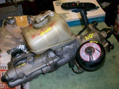

Car developed a problem a short while after the last brake job, new pads and turned rotors, nothing big. Pistons and seals all looked very good and were reassembled with brake lube. Have done the job multiple times on this car with no issues, and this time was no different. Braking was fine after the job was completed.
The problem:
Rear brakes were dragging after application of pedal for about 2 seconds...as pressure appeared to bleed off, normal operation of car, no dragging. Pushing on pedal would re-create. Tapping on pedal didn't seem to be so pronounced.
No codes from ABS unit when shorting pins 4 & 5 on ABS connector and checking dash lamp with Key On.
ABS passes self test at startup, remains on about 4 seconds after car starts and then goes out.
Presumed this problem is isolated to the Teves II ATE Solenoid Control Valve Body. Removed unit from car and removed cover, found lower center valve in the body severely discolored...almost black, like it was burning.... Checked resistance of all 6 solenoids and all measure 3-8 ohms per the shop diagnosis section. No short to ground condition found.
Replaced Solenoid Control Valve body with a unit from another used car, (140K) and now the front brakes are exhibiting the exact same problem, but rears are OK! (I checked all 6 solenoids in this unit, and color and resistance measurements were again within spec.)
To me, this sounds like the dump (N/C) solenoid/valves are stuck closed and not opening properly at the end of the normal braking operation.
I can test the solenoids for shorted (to case) and open conditions, but I cannot test the solenoids for proper operation.
I do not know if they take a +5V signal or a +12V signal to activate....and I don't want to burn them out with too much voltage....and I can't seem to find my +5V power supply at the moment...
I would also like to know if there are any rebuilding services that can clean/test/replace these ATE solenoids.... If I could get known good/clean solenoids, I could replace them easily enough. The plastic circuit board is similar to things that I have soldered on before. Easy does it!
Other info:
Rear flexible hose has been replaced.
Accumulator pressure and pump still operate just fine.
All calipers have been rebuilt and assembled with brake lube.
System has been bled multiple times with clean fluid.
I just can't figure (or find a proper Theory of Op's manual that would explain...) how anything in the actual master cylinder unit would restrict back flow of fluids.....everything points to the control valves that I read. It is just that NONE of the diagnosis charts outline how to test these beyond simple ohmmeter checks. No listed symptoms match the problem!
The fact that I have changed the symptoms (rear to front) by changing the control valve makes me believe I am on the right track. However, the next time I do this job, I want it to be the last!! (On this car anyway!) It is a real bugger to do....not to mention VERY messy!
Hope you can help with some info on suppliers/rebuilders or a way to test these with voltage and an air supply etc!
Thanks,
Steve

Anyway, last night I played with the old solenoid valve control block based upon what the guys in the BMW forum were doing..... I could find nothing wrong with this!
I believe the "discolored" solenoid that I found was simply a manufacturing issue with material used on the end cover....the plating oxidized or was a different color already...... This was the N/C rear solenoid and after dinking around with it using a 12V source and the 7 external pins of the connector, I determined that I could find nothing wrong. Not to say that there wasn't.....I just could not be certain to a 100% level! No smoking gun......
I flushed the passages with brake cleaner, activated the solenoids and flushed again......popped the N/C units out ( can't do the N/O ones due to short leads!) and checked for garp etc found none....
They all clicked and clacked when activated, and when hit with 120PSI of air, they did their job open and closed......
So, I am stumped still.
I like your description of the operation, as it would make sense that the system should operate if the main fuse went out. This is indeed one of the pressure activated units with an electric pump and an accumulator to hold the charge....
This stuff all seems to work just fine! At least when it is in the driveway, or when I drive it!!!! After I discharged the system and changed (only) the valve block, the pump worked fine to recharge the system and I could hear it cycle on and off with each depression of the pedal, until the air was all bled out. Then it held pressure a little longer before requiring the pump to come back on....and it would shut off in very short order. Seems good!
So, in trying to think this to death.........I am wondering what in the system would cause restrictions (or leaks!) to either the front or the rear portion of the system under normal braking conditions! Presuming that what you say is true, about the control valve block being passive under normal braking......where are restrictions (or pressure leaks?) possible....?
Again, I don't understand exactly (inside the M/C assy) how high pressure fluid is routed to the outlet passages (thru the control valve and out to the brake lines) but I will presume that it is stored in the accumulator and from there a line takes it to the master cylinder bore, and from there to the solenoid valve body.....and out..... once you relax from braking, the pressure is relieved back up thru the control valve block, up into the M/C and then back into the reservoir. Once pressure is depleted enough, the pump kicks back in and pumps up that section of the system.... that's my understanding...
The only other device in the lines is a proportioning valve in the rear line, but that doesn't explain the issue now, with the fronts staying on.....
Does the "main" valve hold fluid pressure until you step on the pedal, causing the main piston to pass over some passage in the bore then allowing fluid to flow out?
This is where the information stops.....
Where does high (accumulator) pressure get introduced into the lines....that the pressure could leak past something and stay active in the lines???
What in this scenario would explain the changing of symptoms from rear to fronts if all the rest remained the same???
If I disconnect only the ABS main fuse, and not the fluid pump fuse, to keep the "normal" pressure up in the system, could this serve as a good test of anything??? Or would both fuses need to come out....???
The BBA-Reman outfit looks like they deal with European Fords... Galaxy? Not here yet!!! KA? They don't go as far back as what this system is!
As for proprietary info....I can't agree more! These cars are packed with more bells and whistle type stuff.....that surely is engineered to fail at 99K miles..... A certain "tripmeter" module comes to mind in this particular car!!! Followed by their AM-FM Cassette premium sound units......
Thanks again for your perseverance! This is a doozy! Hopefully something simple...
Steve

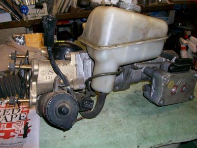

This "Lincoln" unit is a three piece, no vacuum booster affair. An adapter that bolts to the firewall (no connections to it), a booster piece (this is where the hard line from the pump/accumulator connects, and the actual M/C.
The system is of the 6 solenoid variety with 4 for the fronts (separate R & L) and two for the rear circuit which is shared.
You have pretty much said what I have found in the manuals already in: "the sequence for an ABS stop"...
If I am reading you right, and applying it to my T/S process, my failure is during "non-ABS" braking, so the block, bleed, block, bleed scenario is not yet active.....ie solenoid valve activations...
What is the flow of fluid in a non-ABS stop? What "other" valves are in play.....
THIS is the info that I cannot find!
My understanding is that the only other switch or valves is the one valve that determines release of high pressure fluid into the main bore, and then there is one switch that tells the pump to fill or provide more pressure to the accumulator circuit. In my case, these appear to be working. The pump pumps when it should, and pressure is being held until demanded. (not leaking down)
I was hoping to pull the fuses last night on the car...but no car, so this still remains my plan of action.
If normal braking (as long as the accumulator has charge) produces the failure, then I must presume that the issue is in the main hydraulic unit (booster or M/C) some how. A leakage past a seal of sorts....
How the symptoms have changed from rears to fronts is still baffling, but we don't understand the flow of high pressure fluid in the M/C unit yet....there could be a common passageway that feeds the front and rear portions of the M/C (presuming that they are segregated)...and one or both of the M/C seals are leaking pressure after the pedal is release...or some check valve in the thing is not "unchecking".....
I've no luck finding anyone that actually has taken one of these units apart! The units are simply replaced in whole......and either there is success or return to the wrecking yards to seek another part.....
The Ford shop manual does not outline service for this unit.....replace as a whole!

There is something called a "main check valve" and is only briefly described in the shop manual. Diagnosis is limited to a simple ohm-meter check....pass/fail...replace entire actuator-M/C unit! Not serviced...
In description of Actuation Assembly:
"The booster control valve is located in a parallel bore above the M/C centerline and is operated by a lever mechanism connected to the brake pedal push rod. The actuation assembly cannot be internally serviced."
Later in the Operation heading:
...the pump maintains a pressure in the accumulator ans is connected by a high pressure hose to the booster chamber portion of the hydraulic actuation assembly and a control valve. When the brakes are applied, a scissor-lever mechanism activates the control valve and a pressure, proportional to the pedal travel, enters the booster chamber portion of the hydraulic actuation assembly. This pressure is transmitted through the normally open solenoid valve through the proportioning valve to the rear brakes. The same pressure moves the booster piston against the valves in the master cylinder. This applies pressure to the front wheels through the two front, normally open solenoid valves.
This backs up what you said about the system operating in a normal mode, without activating any solenoids. Although they do not really tell you where the pressure goes when you take your foot off of the pedal....I presume it comes back up the NO solenoids and into the M/C assy....
They mention in this section "shutting off the central valves in the M/C"...... Here is where a nice cut-away drawing would be the best!!! What valves? ...and this is where I get lost. No more info....
We push on the pedal, it activates a lever that then allows pressurized fluid into the booster chamber and also into the rear brake lines.....more pressure on the pedal shuts these ???? valves in the M/C and somehow allows pressure out to the front lines.
My guess is that I have an internal leak (or two) in the control valve section to the main M/C bore......leaking through to one of the valves???? Or something like that.....
I'm off to unplug a bunch of stuff and go for a drive!
Steve

Here is a picture of the right side of this unit. If I can post two pic's I'll put the left side in here...if not, I'll put it in another post! Pictures are always worth a pile of words! Steve Right view
https://images.2carpros.com/forum/automotive_pictures/586155_markviimasterright1_1.jpg
Adapter section, booster, and M/C, pressure pump, pressure switch, and solenoid valve block. Left view
https://images.2carpros.com/forum/automotive_pictures/586155_markviimasterleft1_1.jpg
M/C portion with main hydraulic valve portion on top bore (electrical connection at front), booster section, adapter and accumulator. This unit came from a car with 140K on it, and compared to the one in our car, is actually pretty darned clean.....I can only hope that it was replaced!!! Could we be that lucky!?? Kind regards Steve
Oct 28, 2010 at 3:20 AM
CARADIODOC
  • 34,321 POSTS
That accumulator in the lower picture looks just like the one on my Bendix system, warning sticker included. The rest of the system does not look one bit familiar. I see that extra valve you're talking about, but I don't see where the lines leave the master cylinder. Is that one of them going straight into the valve block, and is that the silver valve block on the far right side of the top photo? I see the electrical connector on top.
For what it's worth, my Dynasty was involved in a recall to replace the piston assembly in the master cylinder. I performed the procedure on a customer's car a long time ago, but I just got the part for mine but never installed it. That car only has 4,100 miles so it should last a while! I can't remember what the symptoms were relating to the recall but I don't think it was a slowly sinking pedal. Seems to me it had to do with the pump running too much. At any rate, the cause was the seals on the piston assembly. I'm mentioning this because with Chrysler, anything involved in a safety recall is warrantied for the life of the car. I don't know if that's a Chrysler thing or if it applies to other companies. At that time, in the mid '90s, no other parts were available except for externally-mounted pressure switches. You could not buy pistons for other systems, to my knowledge.
Have you considered asking the Ford dealer if there was ever a recall on this system? The parts department guys or an older mechanic would be the guys to talk with. Service advisers typically don't know or remember about those things from that long ago. If you have a friend at the dealership, you might also ask if there were ever any service bulletins issued. Those are not recalls. They are just sharing known problems to save the next guy from having to spend a lot of time searching for a problem that has already been identified.
I can visualize the symptom you're describing. My gut feeling is it has to do with the power assist section, but I really don't know so I'll keep my mouth shut.
