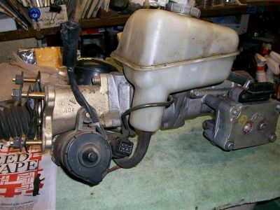

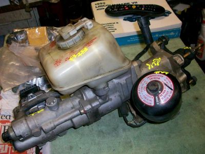

Car developed a problem a short while after the last brake job, new pads and turned rotors, nothing big. Pistons and seals all looked very good and were reassembled with brake lube. Have done the job multiple times on this car with no issues, and this time was no different. Braking was fine after the job was completed.
The problem:
Rear brakes were dragging after application of pedal for about 2 seconds...as pressure appeared to bleed off, normal operation of car, no dragging. Pushing on pedal would re-create. Tapping on pedal didn't seem to be so pronounced.
No codes from ABS unit when shorting pins 4 & 5 on ABS connector and checking dash lamp with Key On.
ABS passes self test at startup, remains on about 4 seconds after car starts and then goes out.
Presumed this problem is isolated to the Teves II ATE Solenoid Control Valve Body. Removed unit from car and removed cover, found lower center valve in the body severely discolored...almost black, like it was burning.... Checked resistance of all 6 solenoids and all measure 3-8 ohms per the shop diagnosis section. No short to ground condition found.
Replaced Solenoid Control Valve body with a unit from another used car, (140K) and now the front brakes are exhibiting the exact same problem, but rears are OK! (I checked all 6 solenoids in this unit, and color and resistance measurements were again within spec.)
To me, this sounds like the dump (N/C) solenoid/valves are stuck closed and not opening properly at the end of the normal braking operation.
I can test the solenoids for shorted (to case) and open conditions, but I cannot test the solenoids for proper operation.
I do not know if they take a +5V signal or a +12V signal to activate....and I don't want to burn them out with too much voltage....and I can't seem to find my +5V power supply at the moment...
I would also like to know if there are any rebuilding services that can clean/test/replace these ATE solenoids.... If I could get known good/clean solenoids, I could replace them easily enough. The plastic circuit board is similar to things that I have soldered on before. Easy does it!
Other info:
Rear flexible hose has been replaced.
Accumulator pressure and pump still operate just fine.
All calipers have been rebuilt and assembled with brake lube.
System has been bled multiple times with clean fluid.
I just can't figure (or find a proper Theory of Op's manual that would explain...) how anything in the actual master cylinder unit would restrict back flow of fluids.....everything points to the control valves that I read. It is just that NONE of the diagnosis charts outline how to test these beyond simple ohmmeter checks. No listed symptoms match the problem!
The fact that I have changed the symptoms (rear to front) by changing the control valve makes me believe I am on the right track. However, the next time I do this job, I want it to be the last!! (On this car anyway!) It is a real bugger to do....not to mention VERY messy!
Hope you can help with some info on suppliers/rebuilders or a way to test these with voltage and an air supply etc!
Thanks,
Steve

Hi fastmerc1. Welcome to the forum. You obviously know a pile about this system so let me change directions for a minute. One thing I've read about many times but never saw myself was a constricted rubber brake hose, that is until it happened to one of my vehicles, and then to a student's two weeks later. I realize the symptoms changed wheels on your car, but just for fun, look for a rubber hose that has a metal bracket crimped around the middle of it. Since the two I experienced, I've been reading about this quite often. Rust builds up inside that crimp and squeezes the hose. Foot pressure on the pedal will force fluid to the caliper but it can't get back to the reservoir so easily so that brake sticks on. Under light pedal pressure, that brake won't apply so it won't stick either. Simply opening up that crimp with a channel lock pliers will solve that problem. On my '89 Grand Caravan, the additional symptom was the brake pedal was very high and hard, almost like stepping on a rock. The student didn't notice that on his '95 Neon, but he did notice one front brake getting hot. Once he had the wheel off, it took longer to fetch the pliers than to make the repair. This problem has been occurring on the rear brakes of the Dodge Stratus now too and its twins, and I've read about it on other brands of cars.
I have a feeling you don't have an ABS problem because a sticking valve, although extremely uncommon, would block pressurized fluid longer than just two seconds, and the chances of a valve sticking partially open or closed at exactly the same spot is very unlikely. What would be more likely would be some crud getting pushed up a hose when you pressed the pistons back into the calipers to make room for the new pads, but even there the junk would be more likely to fall down behind the pistons. You would have seen that when you had them apart. (There aren't many people around anymore who can rebuild a caliper). I would suggest the lip of the dust boot popped out of its groove on one of the calipers as I used to have a lot of trouble with Fords, but since the problem sounds like it started before you had them apart, that isn't too likely either.
Do I understand from your description that you have a three channel system with the two rear brakes working together for the ABS function? I'm more familiar with the Teves systems on the Dodge Intrepid but we worked on them so seldom that I don't remember very much.
I didn't mention some of the other things do-it-yourselfers run into that cause problems because you obviously aren't a do-it-yourselfer. I assume you know about brake fluid contaminated with petroleum product and the problems it causes. Heck, a lot of "professionals" don't even understand the need for high-temperature brake grease! Also, what about grooves worn into the caliper mounts causing a pad's backing plate to catch and not release freely? I've welded up cast iron ABS tone rings for my '95 Grand Caravan, but I've only seen other people weld on cast iron caliper mounts to build the worn area up. It takes a long time to preheat them. Seems it would be simpler to install shims or find a good used knuckle in the salvage yard.
If I'm way off base, let me know so I can delete this reply. If I don't delete it, other people will see you already got a reply so they may not read your post. Otherwise you can repost it again so the experts will see it.

This "Lincoln" unit is a three piece, no vacuum booster affair. An adapter that bolts to the firewall (no connections to it), a booster piece (this is where the hard line from the pump/accumulator connects, and the actual M/C.
The system is of the 6 solenoid variety with 4 for the fronts (separate R & L) and two for the rear circuit which is shared.
You have pretty much said what I have found in the manuals already in: "the sequence for an ABS stop"...
If I am reading you right, and applying it to my T/S process, my failure is during "non-ABS" braking, so the block, bleed, block, bleed scenario is not yet active.....ie solenoid valve activations...
What is the flow of fluid in a non-ABS stop? What "other" valves are in play.....
THIS is the info that I cannot find!
My understanding is that the only other switch or valves is the one valve that determines release of high pressure fluid into the main bore, and then there is one switch that tells the pump to fill or provide more pressure to the accumulator circuit. In my case, these appear to be working. The pump pumps when it should, and pressure is being held until demanded. (not leaking down)
I was hoping to pull the fuses last night on the car...but no car, so this still remains my plan of action.
If normal braking (as long as the accumulator has charge) produces the failure, then I must presume that the issue is in the main hydraulic unit (booster or M/C) some how. A leakage past a seal of sorts....
How the symptoms have changed from rears to fronts is still baffling, but we don't understand the flow of high pressure fluid in the M/C unit yet....there could be a common passageway that feeds the front and rear portions of the M/C (presuming that they are segregated)...and one or both of the M/C seals are leaking pressure after the pedal is release...or some check valve in the thing is not "unchecking".....
I've no luck finding anyone that actually has taken one of these units apart! The units are simply replaced in whole......and either there is success or return to the wrecking yards to seek another part.....
The Ford shop manual does not outline service for this unit.....replace as a whole!

There is something called a "main check valve" and is only briefly described in the shop manual. Diagnosis is limited to a simple ohm-meter check....pass/fail...replace entire actuator-M/C unit! Not serviced...
In description of Actuation Assembly:
"The booster control valve is located in a parallel bore above the M/C centerline and is operated by a lever mechanism connected to the brake pedal push rod. The actuation assembly cannot be internally serviced."
Later in the Operation heading:
...the pump maintains a pressure in the accumulator ans is connected by a high pressure hose to the booster chamber portion of the hydraulic actuation assembly and a control valve. When the brakes are applied, a scissor-lever mechanism activates the control valve and a pressure, proportional to the pedal travel, enters the booster chamber portion of the hydraulic actuation assembly. This pressure is transmitted through the normally open solenoid valve through the proportioning valve to the rear brakes. The same pressure moves the booster piston against the valves in the master cylinder. This applies pressure to the front wheels through the two front, normally open solenoid valves.
This backs up what you said about the system operating in a normal mode, without activating any solenoids. Although they do not really tell you where the pressure goes when you take your foot off of the pedal....I presume it comes back up the NO solenoids and into the M/C assy....
They mention in this section "shutting off the central valves in the M/C"...... Here is where a nice cut-away drawing would be the best!!! What valves? ...and this is where I get lost. No more info....
We push on the pedal, it activates a lever that then allows pressurized fluid into the booster chamber and also into the rear brake lines.....more pressure on the pedal shuts these ???? valves in the M/C and somehow allows pressure out to the front lines.
My guess is that I have an internal leak (or two) in the control valve section to the main M/C bore......leaking through to one of the valves???? Or something like that.....

Here is a picture of the right side of this unit. If I can post two pic's I'll put the left side in here...if not, I'll put it in another post! Pictures are always worth a pile of words! Steve Right view
https://images.2carpros.com/forum/automotive_pictures/586155_markviimasterright1_1.jpg
Adapter section, booster, and M/C, pressure pump, pressure switch, and solenoid valve block. Left view
https://images.2carpros.com/forum/automotive_pictures/586155_markviimasterleft1_1.jpg
M/C portion with main hydraulic valve portion on top bore (electrical connection at front), booster section, adapter and accumulator. This unit came from a car with 140K on it, and compared to the one in our car, is actually pretty darned clean.....I can only hope that it was replaced!!! Could we be that lucky!?? Kind regards Steve

That accumulator in the lower picture looks just like the one on my Bendix system, warning sticker included. The rest of the system does not look one bit familiar. I see that extra valve you're talking about, but I don't see where the lines leave the master cylinder. Is that one of them going straight into the valve block, and is that the silver valve block on the far right side of the top photo? I see the electrical connector on top.
For what it's worth, my Dynasty was involved in a recall to replace the piston assembly in the master cylinder. I performed the procedure on a customer's car a long time ago, but I just got the part for mine but never installed it. That car only has 4,100 miles so it should last a while! I can't remember what the symptoms were relating to the recall but I don't think it was a slowly sinking pedal. Seems to me it had to do with the pump running too much. At any rate, the cause was the seals on the piston assembly. I'm mentioning this because with Chrysler, anything involved in a safety recall is warrantied for the life of the car. I don't know if that's a Chrysler thing or if it applies to other companies. At that time, in the mid '90s, no other parts were available except for externally-mounted pressure switches. You could not buy pistons for other systems, to my knowledge.
Have you considered asking the Ford dealer if there was ever a recall on this system? The parts department guys or an older mechanic would be the guys to talk with. Service advisers typically don't know or remember about those things from that long ago. If you have a friend at the dealership, you might also ask if there were ever any service bulletins issued. Those are not recalls. They are just sharing known problems to save the next guy from having to spend a lot of time searching for a problem that has already been identified.
I can visualize the symptom you're describing. My gut feeling is it has to do with the power assist section, but I really don't know so I'll keep my mouth shut.

The only hard line on this unit comes out of the pump body under the accumulator, goes to the other side, circles up around the reservoir and then into the "booster" section.
Yes, that thing on the far right is the solenoid valve block and the three chassis lines enter vertically from the bottom.
I had all of the factory TSB's at one time, and never came across any recalls for this. Most common problems with these units are a bad accumulator and bad relays and pumps due to the bad accumulator! (runs the pump too much, or switches it on and off too many times...and burns the connections in the relays)
