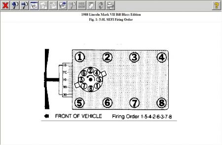

trying to find cylinder order 1-8
Aug 31, 2008 at 7:52 AM
  • 75,992 POSTS
5.0 and5.8L
https://images.2carpros.com/forum/automotive_pictures/12900_fo_17.jpg
