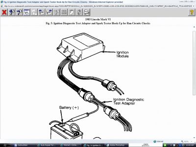

The module has 2 plugs on it, 1 in and 1 out, 1 in has 2 wires, 1 out has 4 wires, now with the key on, the plug in has 1 wire hot 1 cold,and the 1 out, has 2 wires hot and 2 wires cold, what I am trying to find out is, IS that the way it should be, or should it have 2 hot going in and 4 hot out??? Thanks for your time.

Your talking about the Dura Spark ignition module? You need a test adapter if you actually want to test it, this is usually the faulty part. No starts and intermittent stalling the cool down a bit and restarts...
https://images.2carpros.com/forum/automotive_pictures/62217_Dura_spark_1.jpg
