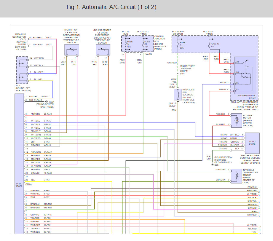

This car has been setting in my shop for a year without being started and I recently purchased it from the owner. Car had some body damage and needed a lower control arm on the left front. I have fixed all that but the AC clutch does not engage. I have checked the number one fuse and the number eight relay under the hood that pertain to the AC clutch, both seem fine. What can I check now? I do not just want to buy a new compressor and other components just to find out it is something else. I would certainly appreciate any assistance you can offer.

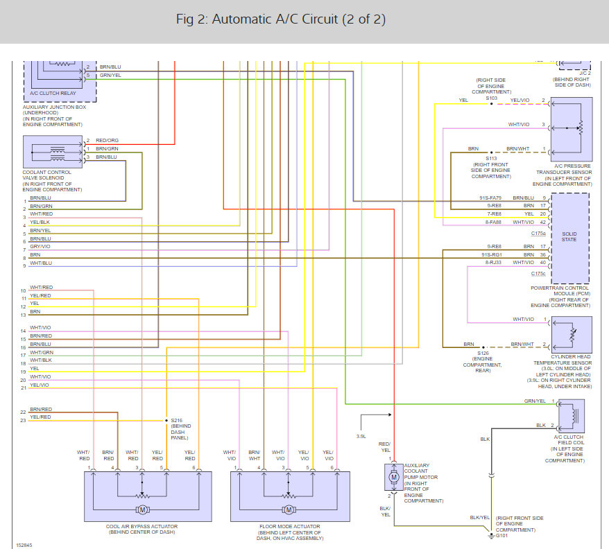

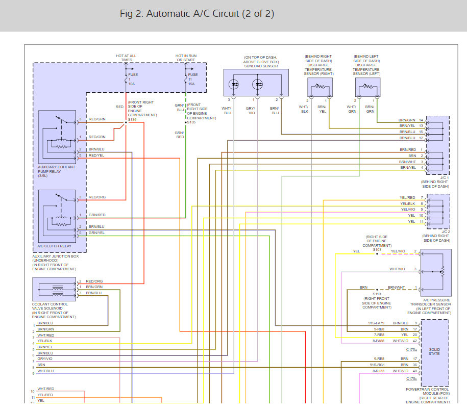

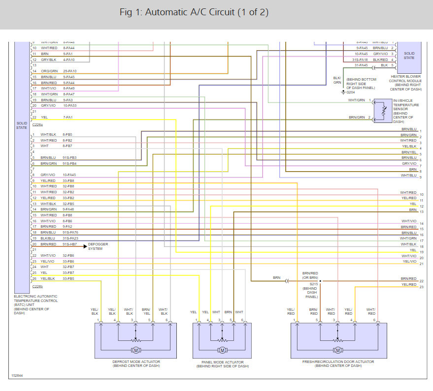

Here is the AC wiring diagram so you can see how the system works.

No power at the compressor. So I am trying to locate the low pressure cycling switch. Can you give me an idea of where it is located?

#FALCONS
I had this problem it ended up being the AC compressor relay under the hood. FYI cost me $34.00 for the part.
