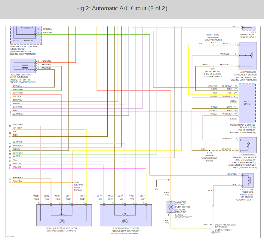

First need to verify the system pressure is enough for the it to work. If so test for power at the compressor if none go back to the low pressure cycling switch and test for power at that, and if there is enough pressure if the switch is working (power on both sides).
This guide can help as well

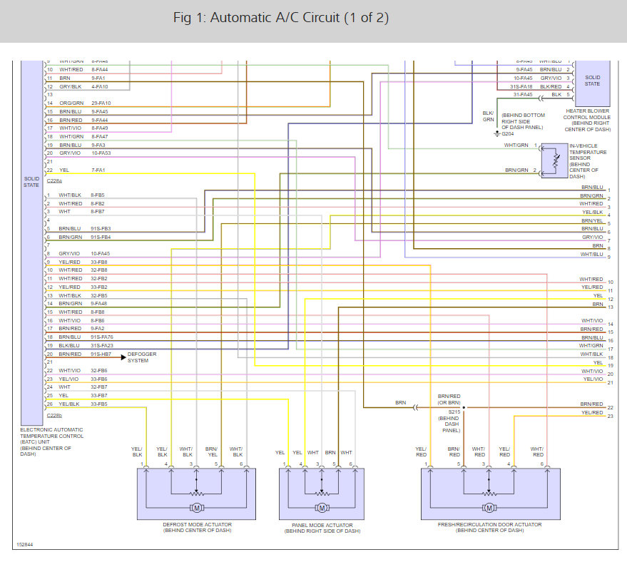

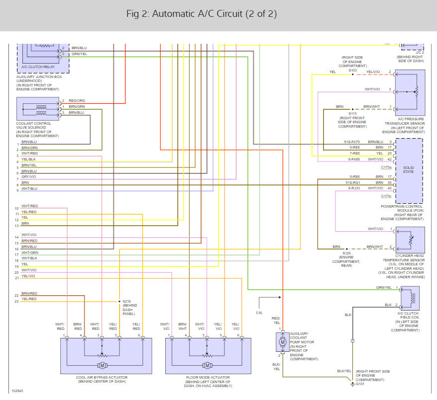

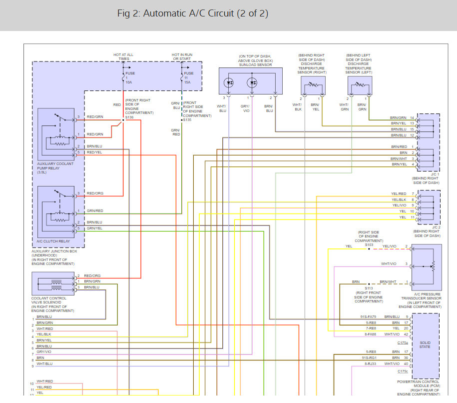

Here is the AC wiring diagram so you can see how the system works.
Cheers

No power at the compressor. So I am trying to locate the low pressure cycling switch. Can you give me an idea of where it is located?

I had this problem it ended up being the AC compressor relay under the hood. FYI cost me $34.00 for the part.
