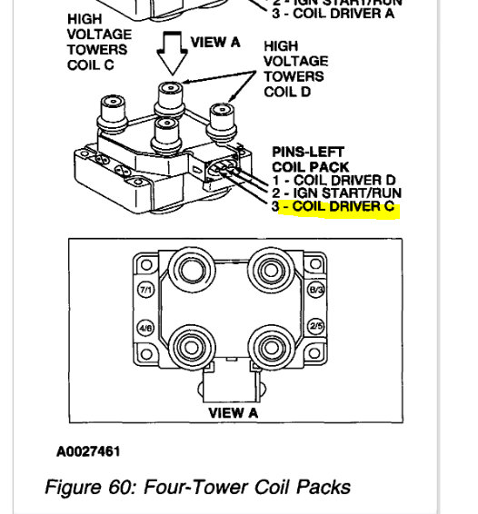

This vehicle has two different possible coil designs. One is each spark plug has its own coil. The other will include two coil towers responsible for four spark plugs each.
If you look below, I attached a pic of what I believe you are looking for.
As far as the misfire codes and coil codes, can you provide them to me so I can get more specifics from my manual?
Also, the EVAP, Fuel Cap, and oil leak are not related to the misfire. That is likely the result of the coil.
See pic below.

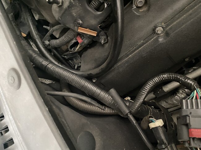

thanks again. I want you to see how I found it.
Nov 18, 2022 at 8:12 AM
  • 110,246 POSTS
That is your EVAP leak. LOL When you reattached it, did the issues resolve?

I have one last question. I attached a pic of a coil above. Is that the style you have on this vehicle?
