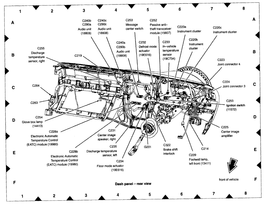

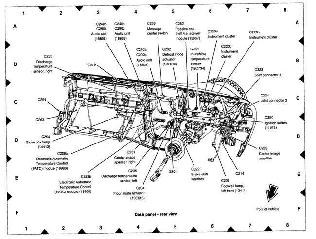

Where is the resistor blower motor located? The air works but fan stays on high.
Thanks, al
Oct 10, 2009 at 12:18 PM
RXLHOUSTON
There is no resistor, there is a control module that varies the blower motor speed. Check out the diagrams (Below). Please let us know if you need anything else to get the problem fixed.
