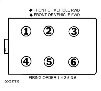

Can you please help me with the layout of the cylinders on my V6? The readout state the #5 coil is bad, but I don't know which it is. I have changed out the spark plugs and the gasket. Sometimes my car stalls and will not accelerate past 5mph. I have to pull over and keep starting and eventually the speed picks up. The car went dead yesterday as I was turning and I had to restart it twice before it started and I smelled gasoline.

https://images.2carpros.com/forum/automotive_pictures/261618_Graphic_119.jpg

Thank you so much for this. You guys are awesome!
