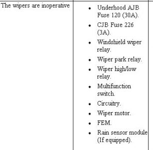

wipers do not work. I replaced motor, replaced wiper relay, checked all fuses in passenger kick panel. windshield washer not working. friends car three visits still nothing. obtained a schematic, little knowledge of this, saw a wiper run/park relay. would that cause wipers to not work? preparing my friend for expense of wiper switch on steering column. any suggestions? help! thanks

I imagine your friend is not too happy right now. This is a job for one that can test electrical components. It would be worth the few bucks to know. These are the possiblilities:
https://images.2carpros.com/forum/automotive_pictures/30961_ls_1.jpg
