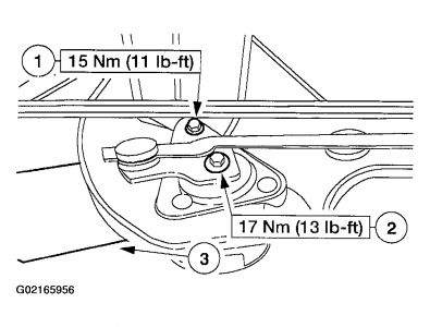

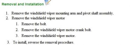

I need to replace the windsheild wiper motor , but i can not locate it. Where is it and what tools do i need to replace it?

https://images.2carpros.com/forum/automotive_pictures/261618_Noname_2268.jpg
https://images.2carpros.com/forum/automotive_pictures/261618_Graphic_544.jpg
