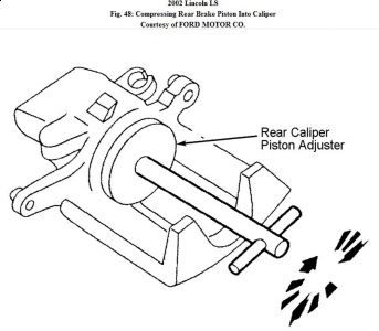

How do I get the piston on the rear brakes to move back so I can install my new brake parts. I use a C clamp to turn down the pistons on the front calipers but it doesn't work on the rear.

Hi mikegee08, Thank you for the donation. You need to turn/twist the piston in clockwise with a caliper piston adjuster.
https://images.2carpros.com/forum/automotive_pictures/192750_BrakeRearAdjuster02LSFig48_1.jpg
