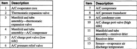

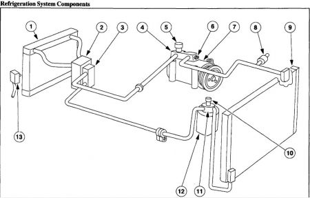

WHERE DO I PUT THE FREION IN MY CAR?
Sunday, May 23rd, 2010 AT 8:51 AM
MECHANIC
75,992 POSTS
You charge it on the low side-see #5 below:
